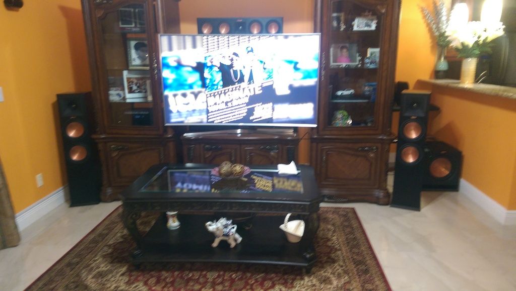

Yes, I did 8 positions and the sub thumped all of them but really low, don't know why it was that low. The rest of the speakers did alright just the surround one have more volume than FL/FR. I will play more and run more calibrations, but I couldn't find a way to turn it off. Was showing just reference or flat.

Here is another vid to watch, its partial reason I said I hate where you sub is located.
BTW,
[Show spoiler]I still hate where you have your sub... lol

Will try to run calibration with the sub in different spot. Now what is the best volume set to run calibration? 50%,20%,100% more % will calibrate at high volume or the other way around.
I really like the look where the sub is but if it sound better on another spot, then will be there.

That isn't the point, it isn't about having higher volume on either device(sub amp or receiver), by having a SPL meter will help give you the proper db levels needed for your room/location.
Yet, I believe your AVR will give you the db level needed before actually doing the calibration. With mine I still use a SPL meter, and I even make my subs hotter afterwards.

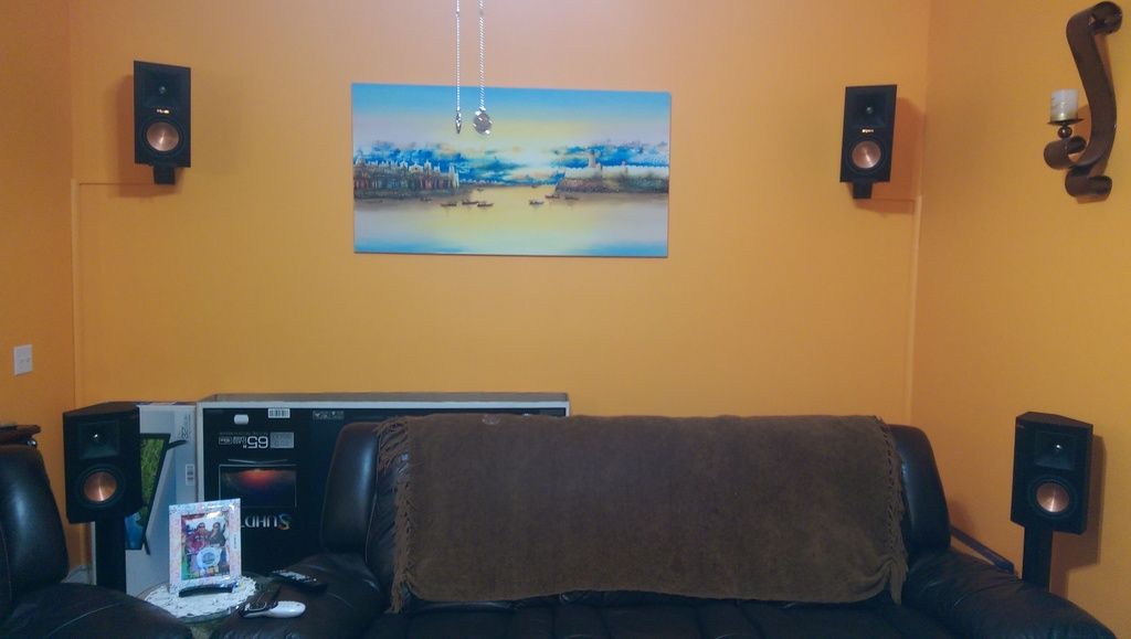

I got mine working good now. Still some tricks I need to do but are less. Like, moving the center speaker below the TV and swap surround with surround back speakers to check the difference. Still preferred the bi pole at surround as there are more sound demand than SRB.
About the sub, I did the same as you with the settings.
At calibration set the sub @ 85db from 75db before.
Set to LFE+Main, fronts speakers set to small and crossover from 40hz to 60hz.
Now I have to go and lower the sub level sometime.
Don't know why you have to buy a second sub to keep them at 40% power when you can put one at 80%, unless your room is large and your sub was max out.

Will get the SPL meter to try. I also change the sub place and the bi pole position. Working on the center channel but I can't find the right way to put it below without compromising something. For now is just tilted down and +3db level. Feels ok i guess.
