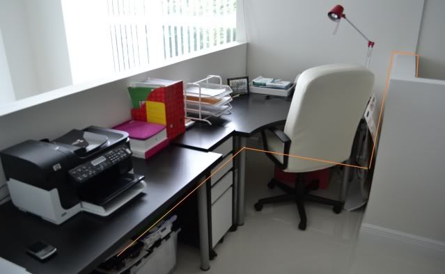

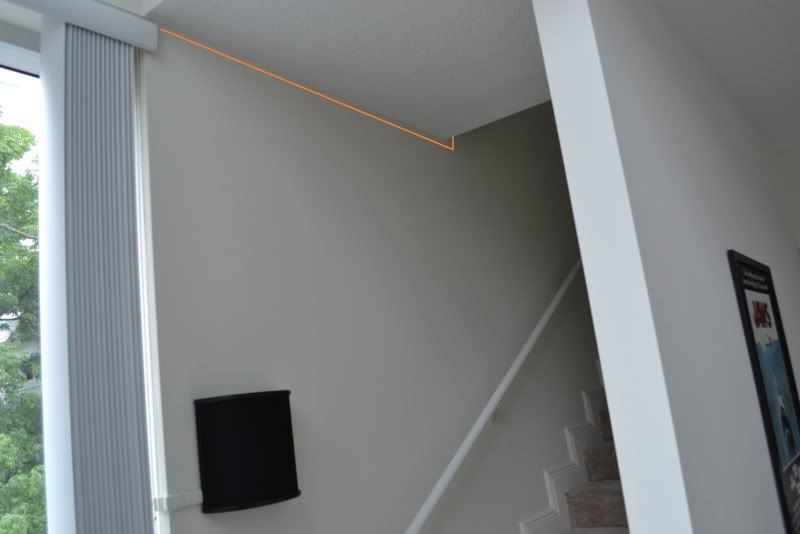

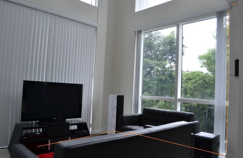

In any case, first things first for mods. Going 7.1. Here's the plan of attack. I'm going to run speaker wire as such:
Follow the uhh, orange line there. Behind everything like how the current Right Rear is wired...around the bases and loft railings...

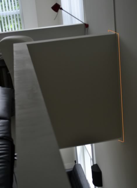

And then, drill through the drywall overlooking the living room from the loft to run cable through to the speakers on the otherside:

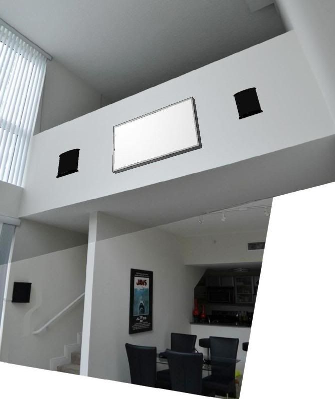

Which is the eventual look. Whether that thing in the middle is: A. A very cleverly masqueraded acoustical panel or B. Art or a poster of some kind - is dependent on WAF. GAF, rather, sorry. I'll see if I can sneak in some sneaky lighting or some such like I'm famous for.

That center thing has the potential to be something special, though - a "Oooh! Ahhh!" moment when you look up at it.

JJ go look at my gallery. I originally had my speakers firing out from the higher wall in my home and I really was not able to hear the surrounds very well. I had a plant shelf made where I was able to reposition the speakers to fire down toward the chairs. Sort of like ceiling speakers. I am not suggestion you do it the way I did it but you might want to take into consideration to build some sort of box so that you can at least angle the speakers down to the listening area (say 45 degrees).

It looks like it would be better this way.

Bi/di-pole are not designed to be angled down like that or the sound aimed at the listener.

I'm expecting the GAF to go nuts when I suggest the idea to begin with. I'm not sure if angling them would make that better! How high above the seating area are yours to begin with?
Mine would be - the little red circle there is my ear - 8'0" exactly to the centerline of the drivers in the surrounds backs. I am honestly not sure of how it will sound. But given all the reflective surfaces I have, the dipoles are really the only way to go. You can't pinpoint surround effects too well at all. Really immersive with just those 2 I have now.
I'm thinking that - there's just the little issue of getting them through that one part of the top left corner of the blinds w/o going around them somehow - and I'm not sure if having a big ol' runner right THERE would be gaf approved.
Either way, I need a ladder...
Yo, I HATE having to consider GAF now.
At my old place, I had the tweeters aimed at 2'6" above the ear. This would be a 3x+ jump. But yes, Hamps is right here.

Originally mine were set about 10 feet high. They were... in wall direct radiating speakers... not dipole speakers. So they were firing directly into the room and I did not get a sense of surround sound. You might have a better sense of surround since you are contemplating dipole speakers.

Good idea for the 7.1 setup. Dipole (or Bipole) Surrounds should work wonderful in that design. I know many say the Side and/or Rear Surrounds should be around 2-3' above your Ear, but those REAR Surrounds up high on the wall, how much higher would those be then the SIDE Surrounds? Either way, once you Calibrate it all
[Show spoiler](via an SPL Meter or whatever you have already)
, everything should be taken into account by the system accordingly Anyway to make things sound the way they should.

This weekend I'll run the speaker and ethernet wires and place and paint the runner. I'm still shopping for the perfect 6th and 7th channel and centerpiece for the railing.
I use the MCACC mike and my own SPL for calibration. But I tweak it after that anyway to suit my own taste. I've never followed [receiver] calibrations religiously.
Steve, you can see the placement of the 4th and 5th channels in that same side interior elevation - they're the squares with a horizontal line running through them. 1'6" above ear level are the tweeters.

Ah, see, that may be it. A lot of wire length, the speakers, the power itself could've been factors in the sound there.
