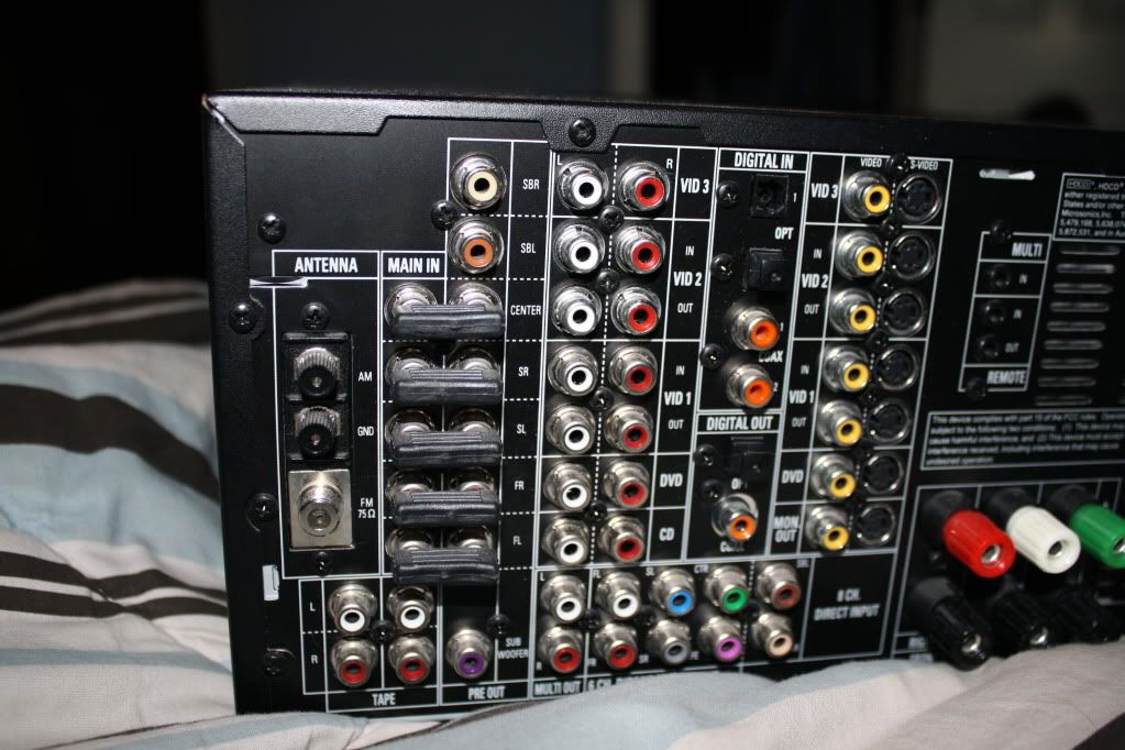

The only other option then is an AVR upgrade .............. And I don't know many that include Pre-out / main -in jacks like those found on my Harman/Kardon AVR520 ..................... (seen on the left)

Russ,
To be clear, we're talking about two-channel stereo receivers, not AVRs.
My model is a two-channel stereo unit, devoid of surround processing and all the bells and whistles that come with that. Here's what it looks like:
There may be a few flagship models that still sport them ..... but they're flagships ........
Again, I don't believe any multichannel A/V receivers boast tape loop connections -- even in flagship form -- as this was mainly a two-channel feature (for hooking up tape decks to monitor or graphic EQs). Don't forget -- in surround AVRs, the equalizing is handled (if applied) by software schemes that analyze the soundfield, a la Audyssey, and that's not the exact same thing as equalizing for two channels.
That's one of the problems with a world gone digital
It's not really a "world gone digital" thing; indeed, there are some two-channel products out there that boast digital inputs and other modern-centric features (though my Onkyo isn't one of them).
