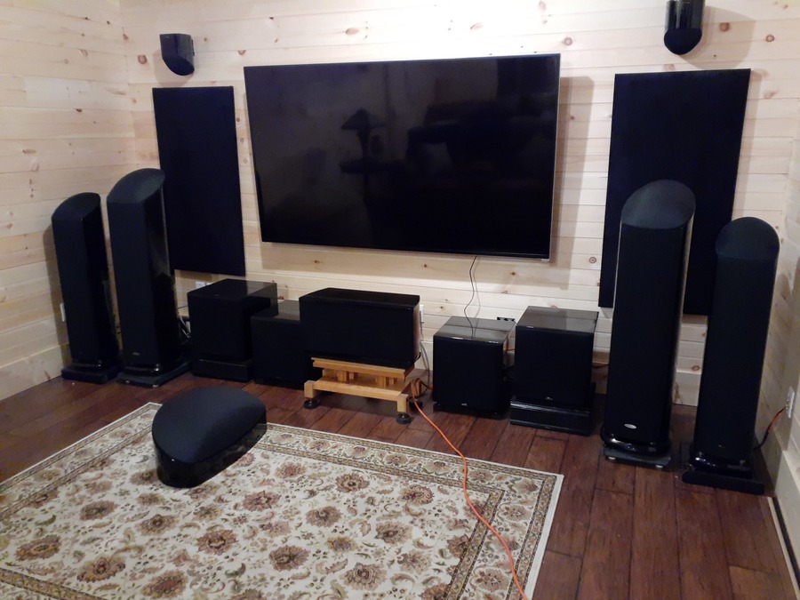

Some OMD goodness up on the wall.... Cannot wait to get the other speaker boxes openned, but that will need to wait until the flooring is done.
Keep us posted on the build out. Looking good so far.
