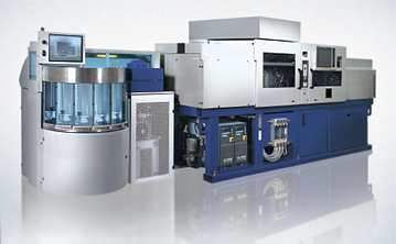

Something I've been thinking about is how do factories transfer images onto discs? At home I only know of printing onto a disc using ink, but studio pressed discs are done much differently. Anyone know about the process involved here?

Just a guess but I would say offset printing, some info here.

The following was in the reference in my first post. For high volume, offset printing makes the most sense.

I don't know if it's the exact process that movie studios use, but I've figured that a high tech, automated machineries are used to print and label thousands of units efficiently, a process that only a manufacturer can incorporate in their facility. An average consumer couldn't even afford anything like that for home use, that would cost millions of dollars to install, and a technician to setup and adjust all of the controls accordingly to specifications of the disc. Besides a average consumer wouldn't need equipment that sophisticated for personal use, unless they're operating a piracy company.

Pressed Blu-rays and DVDs use one of two different methods to print discs;
1. Offset print - this is generally used for full colour photo images. It has a smooth texture and reproduces photos nicely using the CMYK process (cyan, magenta, yellow & black). The draw-back is that this method doesn't reproduce strong solid patches of colour and can look a bit washed-out. This method can't reproduce a specific Pantone shade of a certain colour.
2. Silkscreen print - this is generally used for reproducing solid, accurate Pantone colours creating a much more vibrant result. The draw-back is silkscreen doesn't work very well for reproducing photos as the detail is hazy, gradients are rough and the physical texture is rather coarse. Most of the recent Blu-rays and DVDs use a 1 colour silkscreen (text knocked-out to silver) for simple text-only labels. This method is cheaper than the more expensive offset print method and is very effective for simple designs that use less than 4 colours.
3. Laser Etching - it hasn't been used since the late 1990s but this method laser etched an image in the silver surface of the disc. Warner and HBO video used this method for a few years.
