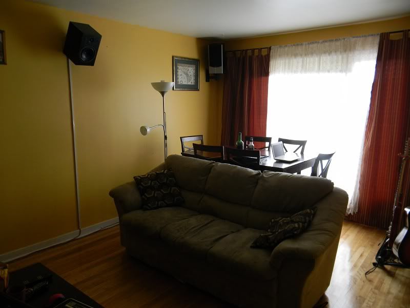

Thanks Big Daddy , i just put a hold on the Bipole`s that i ordered , and made the wife unhappy because i want dipole , but i had a great excuse , she said it dosen`t look good but i said it sounds good , My only question is as you can see in my pictures i will be replacing the black KEF`s with the dipoles but i have to keep the ones in the back were they are . Do you think this will be a much difference or interference from your ideal positioning in the drawings ?

Which manufacture did you put a hold on, and with which did you order the other?
Most and I know not all, have a select switch on them to be either di or bi-pole.
Do you plan to put the di-pole in the same place as the Kef's?
That doesn't look like a good place. It' hard to see how your room is from the pics.
First of all, put a large thick and attractive area rug on the floor in the front of the room to control some of the higher frequency reflections from the floor. In the future, it may not be a bad idea to use some wall treatment. I urge you to consult a divorce laywer before you do that.
Don't buy dipole surround speakers unless you can put them on the side walls exactly on the same line as your listening sofa (90 degree angle) so that you are sitting in their null area. Check the diagrams in post #1.
If you can't place the dipole surround speakers as suggested above, you are much better off buying bipole surround speakers. Bipole speakers are more flexible as far as placement is concerned and have better bass response than dipole speakers.
Both bipole and dipole speakers have a more diffuse and large soundfields than monoploe speakers. You may immediately feel the difference, but it may take a while before your brain begins to adjust to the new sound. They create a better surround experience for everyone sitting in the room. They are not as sweet spot centric as monopole surround speakers.
Surround speakers do not have to be from the same line as the front speakers. There are plenty of bipole/dipole surround manufacturers. If you want realtively attractive, good performing, and competitively priced speakers, check Home Theater Direct (HTD). Their Level Three surround speakers are only $189 each and have ribbon tweeters.

I was going from polk monitors 30 from a seller at ebay , and i was going at the FXi A4 , tomorrow i will take a picture of the end of the room with a wide angle .
The FXi's A4 and the same from the link Big Daddy provided, they are selectable, so you can play with the di-pole or bi-pole configuration.
I too should take a few other angle pics, because someone has told me it's hard to really see how the room is from my pics.
I did make a vid and that helped, but I think I should take more angle pics like you.

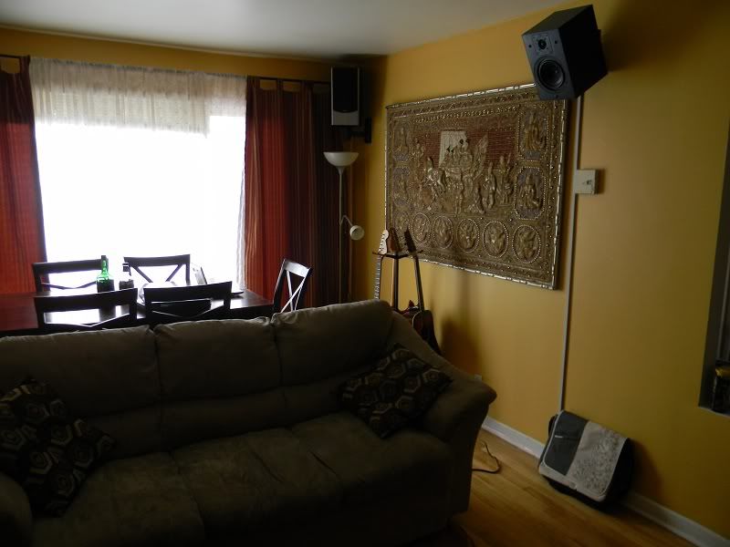

Ok so i took some angled pictures . I am sitting 10ft away from my tv , from the center of my couch to the side speakers angle down is 6ft , from the floor to the speaker is 7ft high the window in the back is huge i only have 1ft1/2 from the wall to the window since it gives access to the back balcony . Also the floors are hardwood .

Hey Almadacr, looking at the new pic’s really helps to understand your layout, compared to what I thought. When I viewed your gallery, I was thinking you were showing the back wall and not both sides.
Don’t forget to put them in your gallery.
I see that you can’t move your rears closer, but from the looks of it, adding the new di/bi-pole to the sides will work out perfectly. If you put your new speakers where the blacks ones are, It looks like it will be the 90degree angle for di-pole, and if you decide to move your couch a little closer to the TV, then you can select the bi-pole.
Looks like your all good to go, just got to get the speakers you and your wife likes
If you put a thick and large area rug in front of the speakers, it will reduce some of the refrections of the higher frequencies from the wood floor and it may help their imaging.
As far as surround speakers are concerned, you can use two bipole/dipole surround speakers. If you can place them exactly within the 90 degree area, use them as dipole. If not, use them as bipole.
It may help if you bring the surround speakers a little lower. Ideally, they should be around 2-3 feet above your head when you are sitting down. Bring them down about a foot or so. They will still be high enough so that you won't have to bang your head against them.
If you decide to replace the rear speakers with bipole/dipole speaker, you can bring them forward and attach them to the ceiling. I have six surround speakers. Three of them are attached to the ceiling with angled brackets from Home Depot.
http://www.homedepot.com/h_d1/N-5yc1...atalogId=10053
If you are going to put bipole/dipole rear speakers in exactly the same locations (top rear corners), don't bother to replace them. The monople speakers will work better in the corners. Bipole/dipole speakers need some room on both sides to have their maximum effect.
Don't mix bipole and dipole modes. Either use all four speakers as bipole or all of them as dipole.

Thanks guys i will only will be hading the side ones , the back ones in the top corner they will stay as they are , i like the way they interact with the rest of the speakers .
Hamp regarding the distance from the couch i will keep it at that since i want to ad a 92inch screen and a projector .
