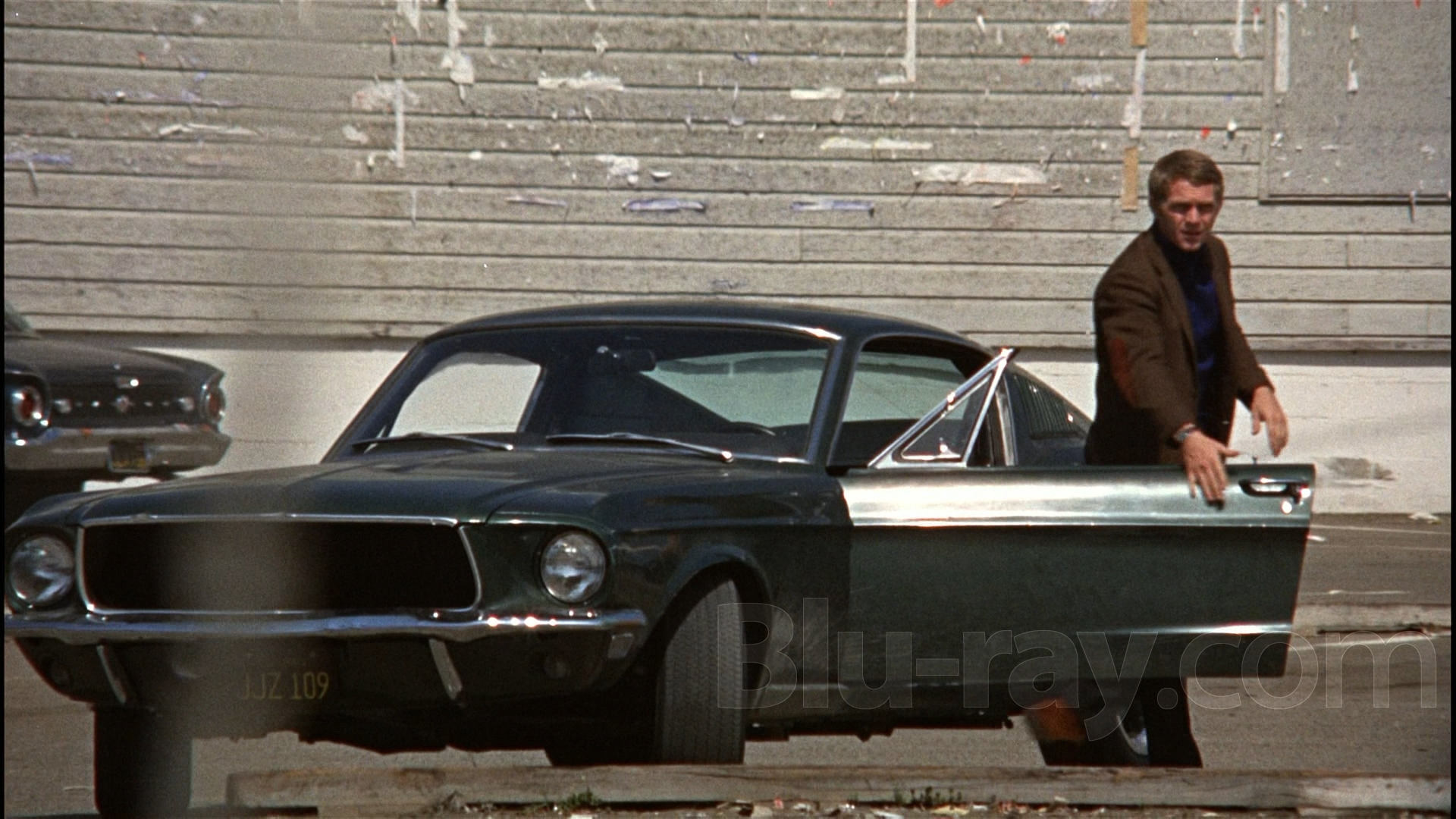

Originally Posted by IntelliVolume View Post
What about 1.85:1 transfers? THOSE will exhibit some minor letterboxing on top and bottom, yes?
Without overscan? They'll look like this:
