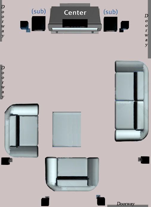

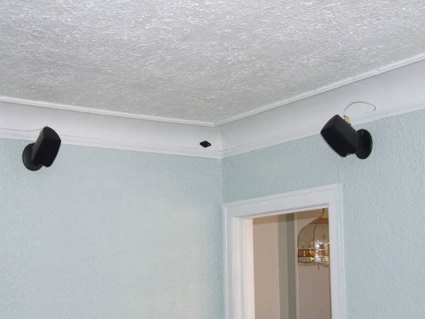

I have changed my front speakers to the outside of my subs like in the drawing. I havn't updated the pics in the Gal. yet.
My Doorways made my room oddshape. I had to put my surrounds up high and point them down toward the center.

Aiming the surrounds downward is great for the movie theater where audience coverage is necessary, and with so many surrounds and the fact that we sit so far away from them, is a must.
At home aiming them towards the listening position changes the direct to reflection ratio, that it actually reduces the spaciousness you are supposed to hear in the surrounds. It makes them too direct as source. That is not what you want in the surrounds. You want a more diffused sound, not a direct sound. Also aiming the surrounds directly at the listening position increases the chance that you will have HRT effects that position things in wrong places, at least to the ears.
So would you suggest trying my rear surrounds behind and over the sofa, while pulling the sofa as far off the wall as I can without harming my viewing angles? Or just stick with 5.1 in my shallow room?
By doing this at home isn't it about same as the theater by covering a wider area or making the sweet spot larger?
or if the speakers are lower and the person is sitting right next to the right surround, it would seem that the effect from the left isn't the same since the right speaker is so close and loud.
No, it does not. Remember, you are sitting(if you sit in the center of the theater) a good 30-40ft away from the speakers, so you want a little more directness because you have 12 speakers instead of just two. By aiming them downward, you actually decrease the size of the sweet spot by creating a more localizing sonic picture with them aimed downward.
I didn't say lower them, I said aiming them was a problem. You keep your surrounds at least 2-3ft above your head from a seated position, facing straight(not down) at let the reflections widen the sweet spot.
