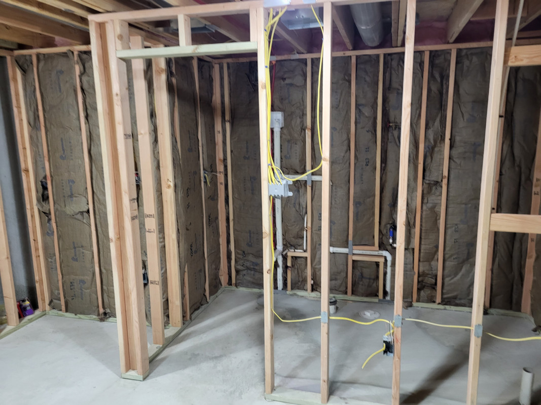

Insulation is pretty much in. Inspection is tomorrow.
After that, the shower base needs installed in the bathroom, and then it's time for drywall!

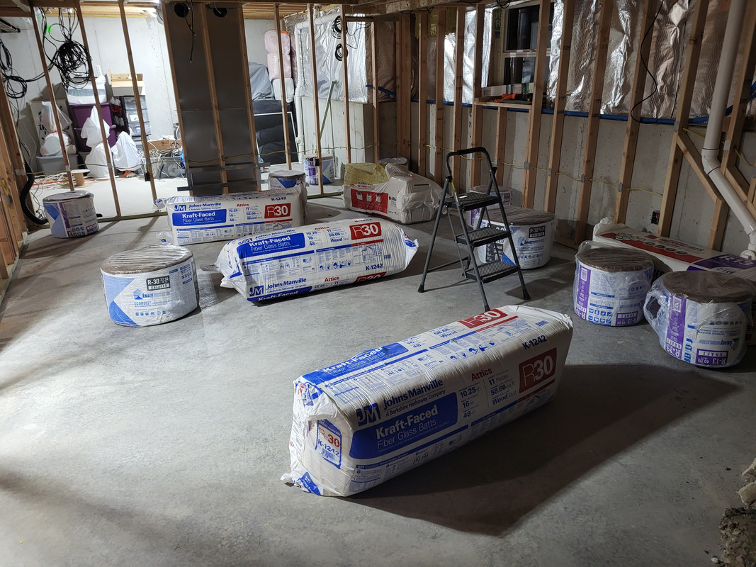

Well, it's been a little slow going as of late.
Follow up inspection went fine, and everything is ready for the shower install and drywall.
Had to get all the drywall delivered, as well as the material for my stage and riser. Basically anything that is large. We have to remove the larger window in order to get that stuff in the basement, so I had to make sure I had it all on hand so we only have to do it once.
Unfortunately, during the drywall delivery, I was putting the smaller items (compound and cement board) into the garage, and I think I slipped a disc in my back. I've been in quite a bit of pain for about 12 days now. I'm starting to move around a lot better, but the pain is transferring to my knee, which is very uncomfortable.
My contractor also had other work he was doing, so he hasn't been able to begin the next step yet. He was hoping to start tomorrow or Friday, but it depends on the weather since materials need to go outside to the back window. Can't have the drywall getting rained on.
Anyways, here's some images of the insulation (some of which I had to correct, as they were lazy and didn't cut out around outlets and that sort of thing).
Laying everything out:
Then insulation installed:

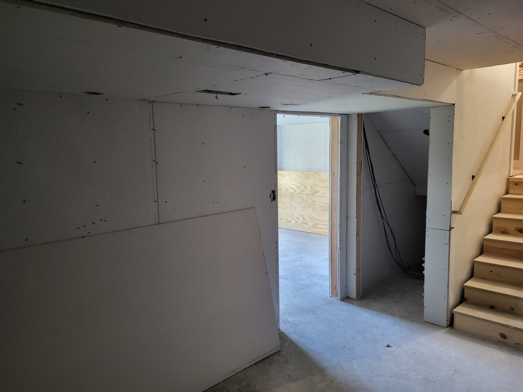

Got the drywall up. Anything touching the theater is 2 layers of 5/8". The rest is 1/2".
Still an area without drywall in the unfinished space since there is still some electrical I want to do in the riser after the final inspection. Once that's done, it will get drywall as well (and the windows).
Tiny issue with the shower needs fixed.
Mudding will start tomorrow.

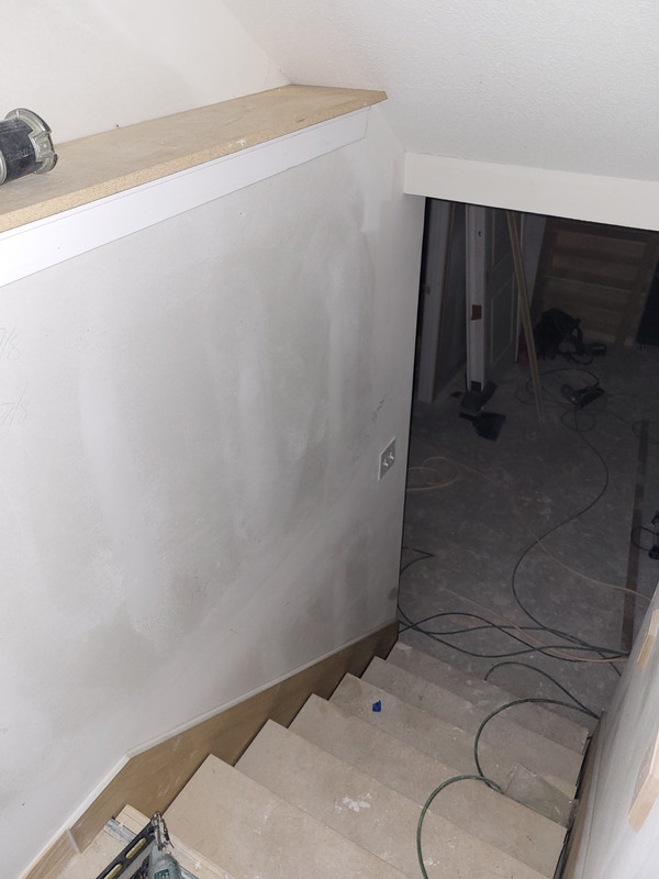

Over a month since my last update. A lot has been done, but not nearly as much as I'd like.
First, some pictures of the drywall with some tape and mud. You'll notice I went ahead and cut my holes for the ceiling speakers. I wanted to get that done before the paint so all that drywall dust wasn't hitting the flat black paint.

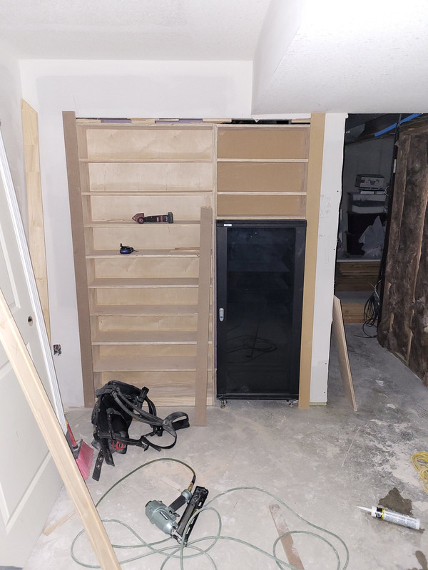

Then after that, the trim, doors, and cabinet was installed, and the media shelf built:
