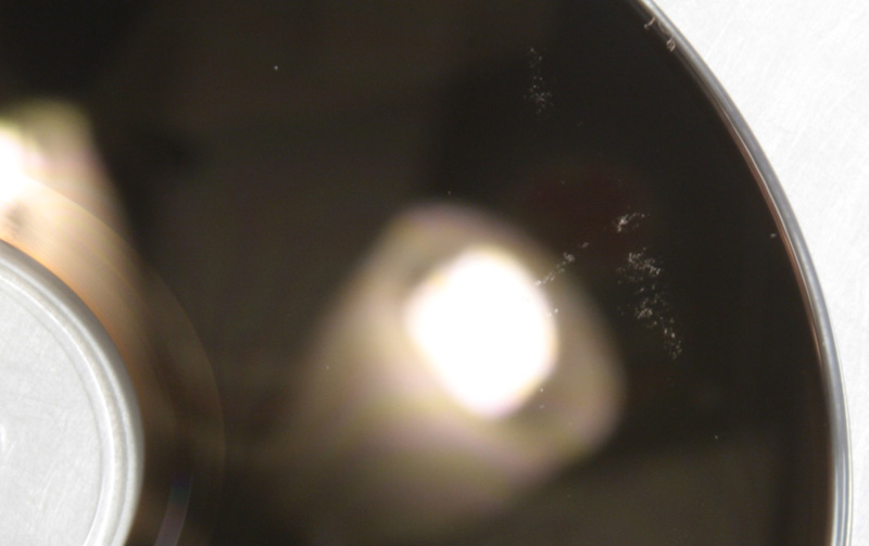

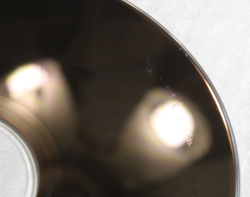

Okay, photo time... Shiny surfaces just don't photograph well... So I used a couple of BD-Rs mostly, since the dark surface shows the pits better. I included a picture of a retail disc as well, but it is much harder to see.
The first picture is the really obvious one. This is the one where the discs were stacked sort of offset, so the inner ring (which is indented on a disc for spindle stacking protection) was sitting about an inch off-center from the disc below it (and with several discs stacked above it). (Note- these discs are completely clean of all fingerprints, dust or any sticky residue. The marks you see are actually impressed into the surface, and can be felt if you gently run your finger over them.)
The next three pictures are the more frequent damage I was finding after discs had just been stacked in an even column in these sleeves. This was usually limited to the far right and left of the disc, where there is an extra fold in the sleeve holding it together. The third image is a close up of the second image so you can see a little better that these are actually impressions in the material.
And this last one is an attempt at photographing the damage on a retail disc (well, a check disc technically). In between the light bulb reflection and the outer edge of the disc you can make out little spots. Those are the indentations in the surface of the disc from the Tyvek sleeves.
None of these discs will play all the way through any more. As mentioned in my original post, other discs I had like this that I gently 're-melted' with a hair dryer now work again, so at least it's somewhat fixable. I have no idea if the impressions will slowly re-appear (or if they would eventually go away on their own), or if the heat from the hair dryer will cause any kind of damage later on. (For what it's worth, I'm actually using a heat gun and taking an 'I don't care if this disc lives or dies' attitude with applying the heat. So if mine are surviving the process, anyone gently using a normal hair dryer should not have any issues...)
Keep in mind, I'm not blaming the sleeves themselves. I had another disc in a paper sleeve, and it had similar problems. I just believe that anything that touches the disc surface long enough will start to distort it... If you ever get a disc in a sleeve of any kind, best to put it in a plastic case made for discs of some kind (CD case, DVD case, Blu-ray case, or even stacking on a spindle). These all are designed to keep the surface of the disc from contacting anything. (If you use a spindle, don't put so many in there that they apply pressure to the lid of the spindle. This will push the discs into each and defeat the purpose of the little rings around the hubs. Use the little foam rings that usually come with spindles of new discs.)
