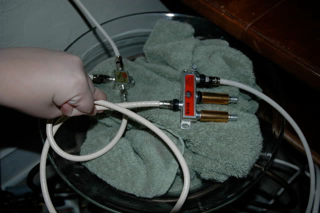

Default Photos

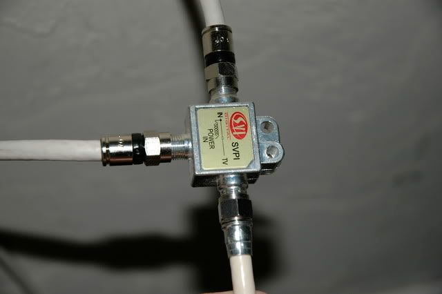

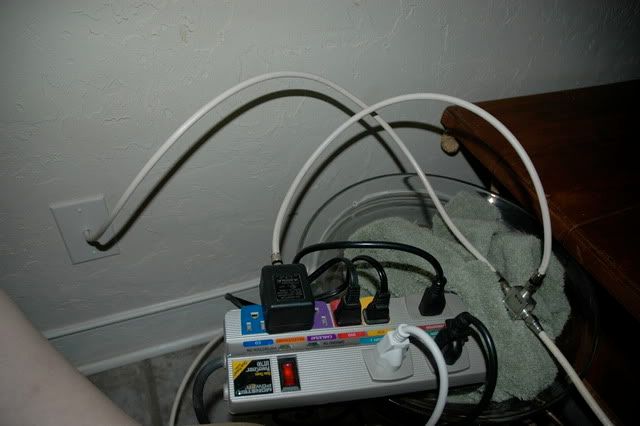

As you can see from below, it connects from the wall to splitter (photo #2), where it then splits to connect to the black box that connects to the power strip, and the other connects to the 2nd splitter (photo #3)
http://img.photobucket.com/albums/v1...s/DSC_1080.jpg

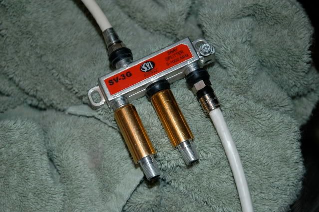

That connects to this splitter (close up): http://img.photobucket.com/albums/v1...s/DSC_1082.jpg
http://img.photobucket.com/albums/v1...s/DSC_1083.jpg
Close Up: http://img.photobucket.com/albums/v1...s/DSC_1086.jpg
From that it connects to the TiVo box

take the one cable that is on the output of the 3-way splitter, plug into to the other splitter/amp tv output. the cable that goes from the 2-way to the 3-way does not need to be there as well as the 3-way. what was the reason the tech told you, you even needed the splitter/amp? my guess is that your signal is to weak comming in but then the splitter/amp overdrives the signal so it needed to be attinuated with the signal loss of the 3-way splitter.
So I should just take the cable that comes out of the T-shaped splitter and plug that into the TiVo? And get rid of the three way splitter all together?
If I remember correctly the cable guy said something about the signal being weak and that it needed to be boosted. Will changing this cord set up have any effect on the signals that are going to my other TV's around the house? He said something about this signal affecting the other tvs, like if the little black box gets unplugged... Basically I would love fewer cords but not at the cost of messing up my signal =) Thanks for any help!

as long as the cable coming from the 3-way splitter is not feeding anything other than your tivo it should be ok to remove the 3-way and go directly to the tivo. as far as the amp is concerned.....how many cable outlets do you have? you generally do not need an amp unless you have alot of outlets, if your drop from the street to the house is TO long, or if your outlet is to long causing to much attenuation. alot of lazy cable guys will just slap in an amp if the wiring is in bad condition or its really old because its a quick bandaid and keeps him from spending two hours rewiring everything.
