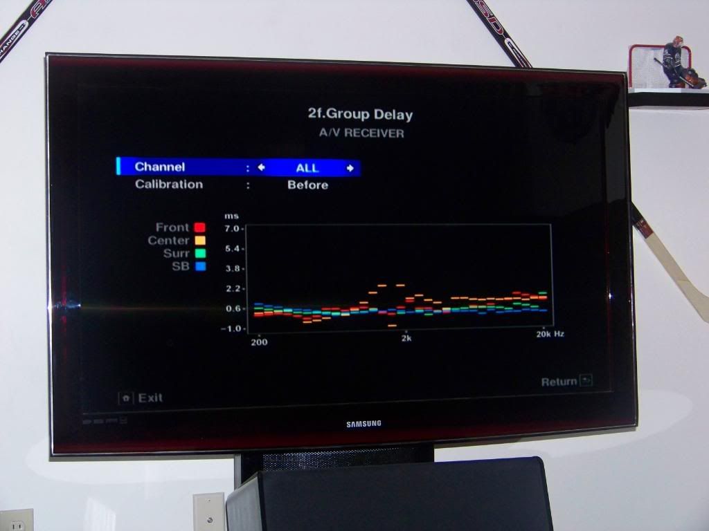

OK, now I thought it would be really cool to post pics of the calibration graphs done by MCACC. I can’t really grasp what I am looking at, and would like anyone’s additional input on these. I am hoping with these graphs, you can get a really good idea of what kind of obstacles are incorporated with my room’s boundaries and to offer possible tweaks/suggestions for my SC-05, so I may further improve its performance. For the Acoustic Calibration, I only posted my front soundstage, the C/L/R. Any and all constructive advice is welcomed.
For what it is worth, on the following 3 charts, Red = Fronts, Orange = Center, Green = Surrounds and Blue = Surround Backs
