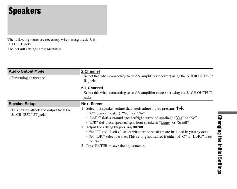

Hold the phone. Crackin was onto something with the manual. I found this in the manual.
** Notice the underlined 2 channel is default. Go into your settings and make sure 5.1 is selected, otherwise only the L/R will have sound coming from them.
Cheers

Thanks guys.....changed it on the blu-ray and everything works awesome.....however, I might see if i can use the tv as the center speaker just to see which is best.....any input here? my tv is able to be used as a center speaker, and if the sound is coming from the hdmi it might sound better, not to mention that is 2 speakers as opposed to the smaller center speaker i have.
