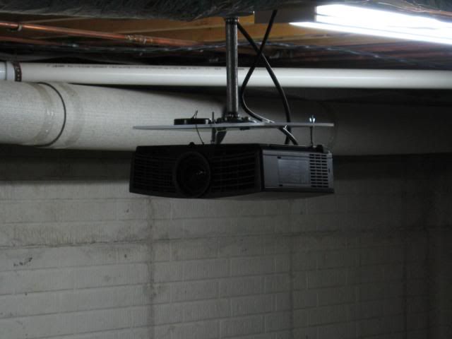

It weighs about 7lbs. I will post some pics tomorrow of the ceiling mount I made.
Here is where I got the idea for mine....
http://www.avsforum.com/avs-vb/showthread.php?t=232749

Here are some quick pics of my old setup in the basement, and the projector and
screen setup. Remember, it's a work-in-progress, so I'm far from being done. I can
atleast enjoy it now, though.

nice! Screen looks great too!
