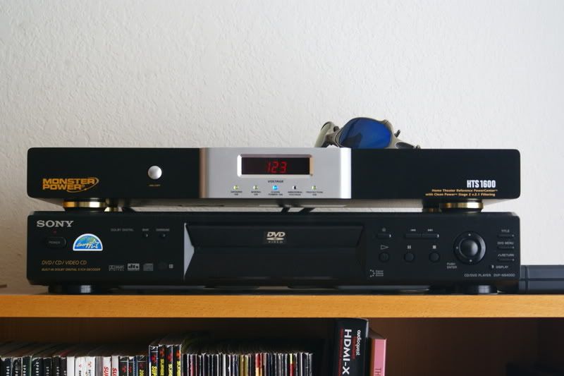

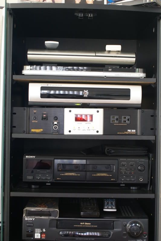

sakbarzad sakbarzad is offline
Jan 2007
Originally Posted by Rustmonsteru View Post
I just have really bad fluctuations where I'm at. 120v is standard but I get anywhere from 117v - 124v up and down throughout the day. Yucky.
i have that same problem at my house
but these are my surge protectors...
the one in my bed room (monster hts1600)
the one in my living room (monster pro3600 comes with an add on light )
