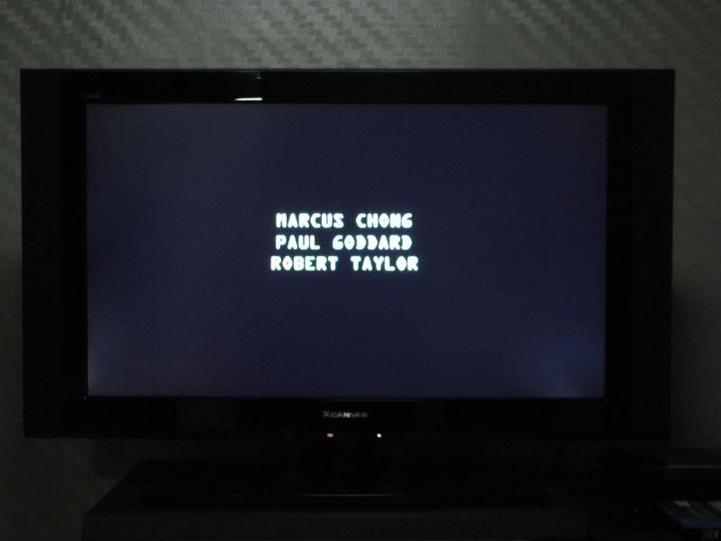

No longer as much of a fan of LCD sets for any situation where there are letterboxes or watching movies at night. I know different models from different manufacturers can be either fine or not fine.
Here is my thread about my problem with two LG sets, complete with photos. It is important to note that LG did take care of me by replacing my set twice -- once with another LCD (seen in photo below) and now with a PDP, which is coming on Monday. I just can't deal with the uneven image/clouding in the corners, even though the LG tech guy stated, "This is normal for an LCD Panel TV."
I posted this over on AVS, and mentioned that the problem didn't appear until after an hour of warming up. A TV technician over there stated that the issue is a manufacturing problem. He basically said that the LCD panel is fine, but it was somehow screwed together too tightly. When heat builds, parts expand, and put pressure on the panel, creating the clouds. It made sense to me.
LG has since ended manufacturing this model, although it is still for sale until inventory goes away. My set model number is 42LB2DRA. I'm so sad about the clouding problems, because the picture on this Full HD TV is gorgeous in High Def. At the time I bought it, nothing else came close. Since then, other models have come out from other companies that are even better. Really a shame -- I loved almost everything else about this LG Xcanvas, and the sound (including 5 channels with sub) was awesome. My new PDP won't have that good of sound.
Photo taken during credits of "The Matrix."
