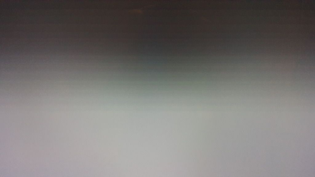

I do have to ask though, hopefully Robert take a a glance at this page. But on the screen you get that i have shown below is it supposed to be a smooth transition from dark grey to light grey? Or, is there supposed to be horizontal bars like that?
As far as the Netflix thing they're talking about on AVS. Yes, the Black Netflix screen does get bright with looks like some grey clouding. They look like clouds. But it's not as bad as what that pic that person posted. But, on the menu where you choose who's page you want to go to (yours, friends or family) the black background is full on horizontal bars.
I don't know if it's the Netflix page, but then again I do get it on the screen you get when you have nothing plugged in or on on the input.
When I see the gray screen when there’s nothing being fed to a particular input, all I see is an entirely uniform screen. I don’t see a darker image up top fading into a lighter bottom half of the screen, nor do I see any horizontal bars. There’s aomething wrong there and I’d consider getting a replacement.
It’s a little concerning that both you and another member at that ‘other’ forum are seeing this. I’m actually awaiting a replacement for my Z9F… meant to be delivered tomorrow. And honestly, I’m sort of scared now based on what I’m seeing others report, lol.
Like, my TV is prereeeeeeeetty much fine, but I see a minor column of light bleed along the right hand side of the screen. It’s a ‘once you see it, it can’t be unseen’ sort of thing, and for $3500, I believe the expectation with this television is that we shouldn’t be seeing such a thing. Others have told me they don’t see this on their television at all so… I’m rolling the dice and hoping to get something that’s even better.
If my replacement arrives tomorrow and I see what you’re seeing, I’m going to tweak out, lol.

I think the horizontal bars are just a result of the android interface rendering errors, I saw them on the Z9D and 940E occasionally but never in content.
That clouding on the avsforum is pretty funny and typical of LCDs, especially low quality ones with low contrast ratios. Would definitely prevent a "zero-DSE" image and have an unfavorable impact on uniformity.

I would have never questioned it until I saw the Netflix bars on the menu. I have yet to see it on the Panasonic 820 menu screen that's also black. Then again, that's on Cinema Pro 2 while Netflix kicks on Standard. Big difference. So maybe I should check out the Panny menu in Standard? Or it's just menus on the Sony Tv. But I did question some Blue (shade) daytime scenes in Mad Max of seeing things.
Besides that, PQ wise i haven't noticed anything. I do want to grab some slides to try out
There may be a bug in Sony's picture processing that you can't turn off that may be causing some of these anomalies because when you are watching content they are not visible. If it were related to the panel, etc, you would see this all the time with content. This set is so new that i would wait to see what the next firmware updates do.
Edit: Just read some of your previous posts and you said you were noticing this with Standard PM. Since your set is calibrated, you should be using either Custom Pro1 or Custom Pro2 so when you use your built in apps, make sure you are using one of these PMs.

I asked jrref to reply as he is our professional calibrator and has communicated this through proper channels to Sony to look into.
I believe the issue is related to the scene being a low grade compressed signal that is created in SDR.
I understand it can be thought of with some concern, but if the banding can't be seen in normal content this should be a non-issue
