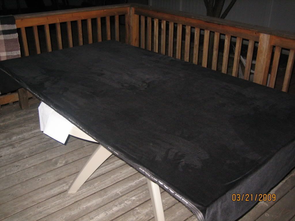

If you do end up using velvet, what type are you using? Might I suggest Fidelio, as it is thought to be some of the blackest and finest out there: http://www.bymichelle.com/fidelio.html , although it is frequently out of stock. It's $24.95/yd
Here is a comparison pic of Fidelio vs speaker cloth vs GOM vs commando cloth, all black (left to right):
I think the Fidelio wins the "none more black" award...

That is a big difference in black. Through my comparisons I did conclude that the black velvet was the most black, non-reflective material (almost like looking into an abyss) I could find. The velvet I priced was from JoAnn's fabrics called Black Premier Velvet. Too bad the fidelio will not be in stock until mid April, otherwise I would have purchased it right away.

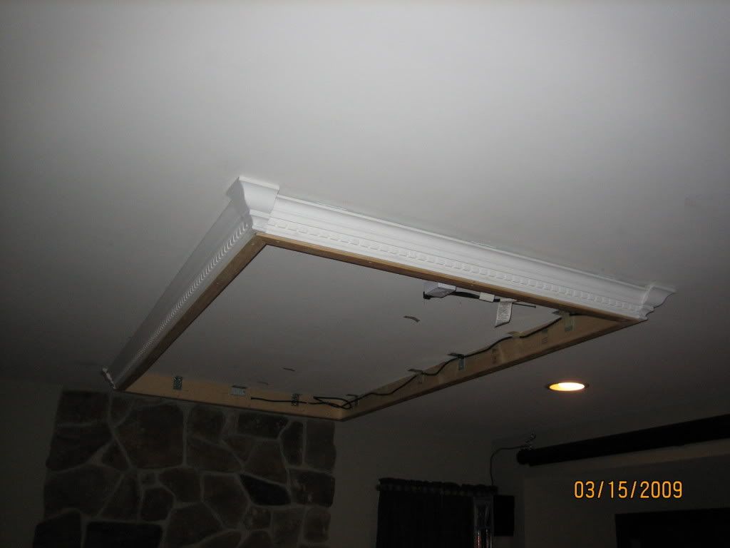

Old 03-15-2009, 07:04 PM   #31
mosteve mosteve is offline
Junior Member
Hi Vega2K
That rigid light weight insulation is what I was talking about that I used in mine. Its cheap and light weight and easy to work with. I really like yours and Brain sturgeons idea about the black velvet idea I wish I would have thought of that when I did mine. (that fidelio velvet is the look I wanted) So are your fiber optic cables behind the velvet or poking though? Also your link on controllers is great some are not very expensive and the low heat and long life of led's is something to consider if you were going to have it on alot. When I did mine there weren't many controllers to choose from and a cheap one was about $300.00. ( the one with the shooting star also caught my eye)
Also something you might try is to use a wood burning tool or perhaps a pencil type soldering iron to open up and to distort the end of some of the optic cables. This gives the apperence of different size and shape stars so they don't look so uniformon. Different size optic cable also helps with this. Try this on a scrap piece of fiber optic cable and shine a light through it in the dark and see what you think. Also if I remember right they make special cutters for cable so you dont smash the end but it seems like when I did mine that I read that finger nail nippers work for this just as well
Keep the updated pic's coming I am enjoying your progress......steve

Thanks for the feedback. The fiber optic cables would poke through. I really like the idea of distorting the ends of the fiber, I'll try that out and see what happens. I really wanted to stay away from halogen illuminators because my set-up requires the unit to be behind the panel next to the ceiling. Those things get hot and since it would be in the ceiling, I just did not feel as comfortable as someone who would have the unit in a closet or in another room. The LED stays cool and the units came with a fan anyway which is perfect for my next to ceiling set-up. I will post some progress pictures next.

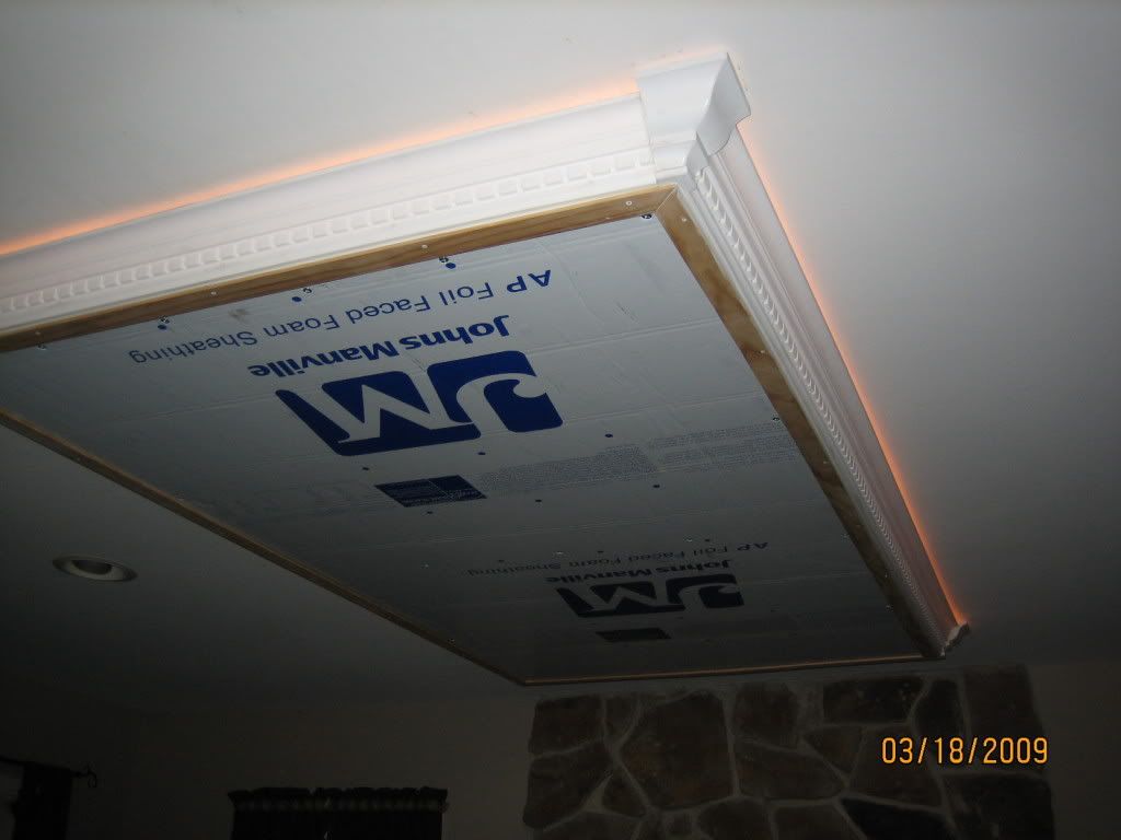

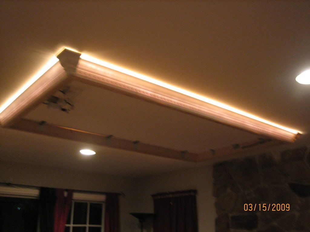

Default Some new progress pictures
I spent most of the weekend working on the non-star ceiling portion of the project, but it was important, so here are a few pics. Thanks for visiting and don't forget to visit my gallery for more details.
Crown molding in place. Need to paint... or do I????
Low lights in the room (sorry for the picture quality):

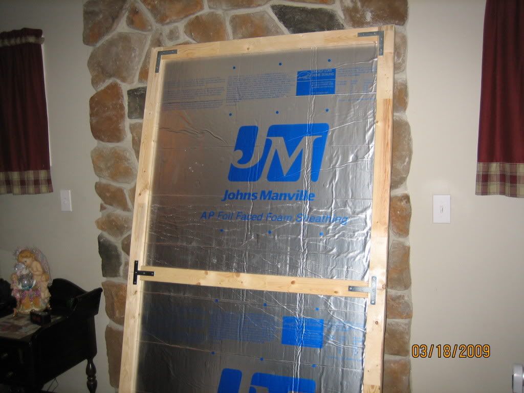

Default 3/19/09 Update
It's slow going with several other things going on right now, but here are a few pics of some progress:
Panel is complete. The rigid insulation assembled with the wood support frame.
It fits!
- I decided to modify the illuminator using an idea from the wife. I super-glued pieces of blue transparent paper (from 3-D glasses) to the wheel. This will change the color of some of the fibers as they twinkle.
- I will be painting the wood lips which holds the panel in place. Two sections will stay in place, but the other two need to be removable in order to install or remove the panel.
- I have printed the constellations on a piece of paper which I will draw grid lines on. I will then draw proportional grid lines on the panel and then use a marker to locate all the stars before I puncture with a needle or drill.
Almost there.

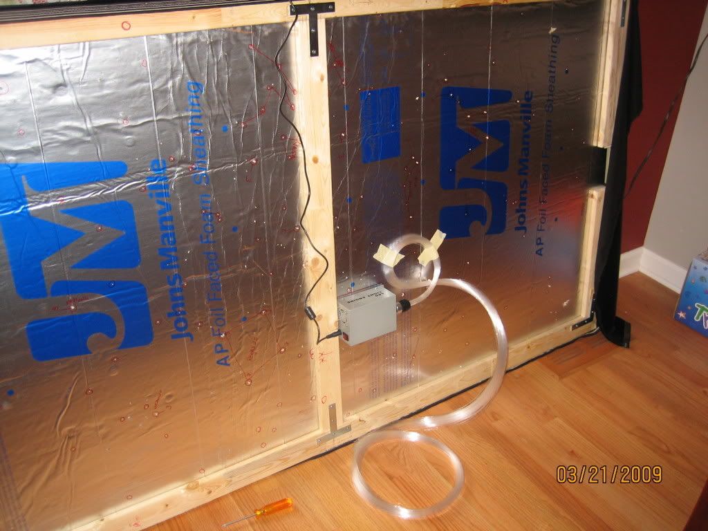

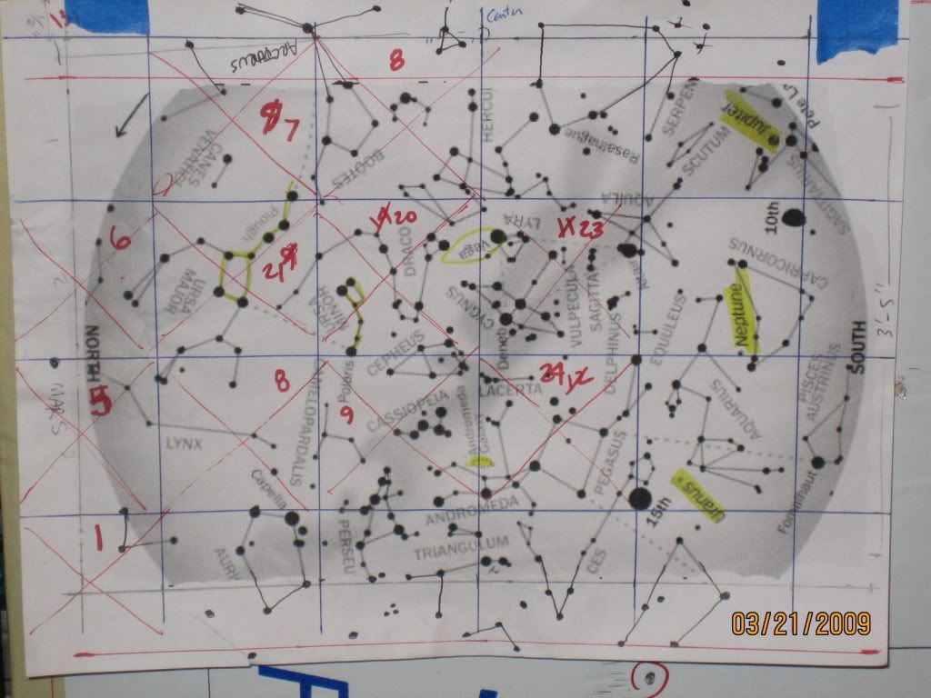

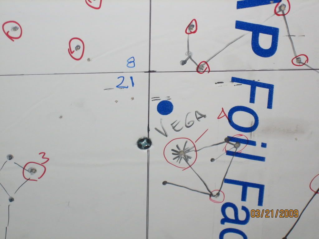

Default 3/22/09 Update
Here's some progress this weekend.
The constellations I transfered to the panel with the grid lines. I counted the fibers needed and wrote them in red. I have 200 to work with.
Here's the transfered constellations (to the best of my ability). I had to omit many because I would run out of fibers:
Close-up of transfer. Note my favorite star
Once I finished the transfer, I needed to puncture (drill in some cases) and mark those stars requiring more than one fiber as well as note the main constallations on the back - remember that the front will be covered with the velvet, so you won't be able to see what goes where. Below is the velvet glued and stapled onto to the insulation panel. The spray adhesive and staple combination worked well, but it was a bit difficult getting rid of all the wrinkles. I had to work fast and patience is key.
Here's where I decided to place the illuminator. I fastened it to the panel with velcro making sure I had access to the power switch and connector. I made sure the 200 fibers would reach the two extremes of the panel.
More to come.
