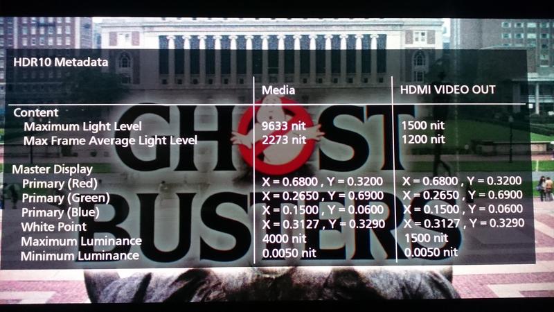

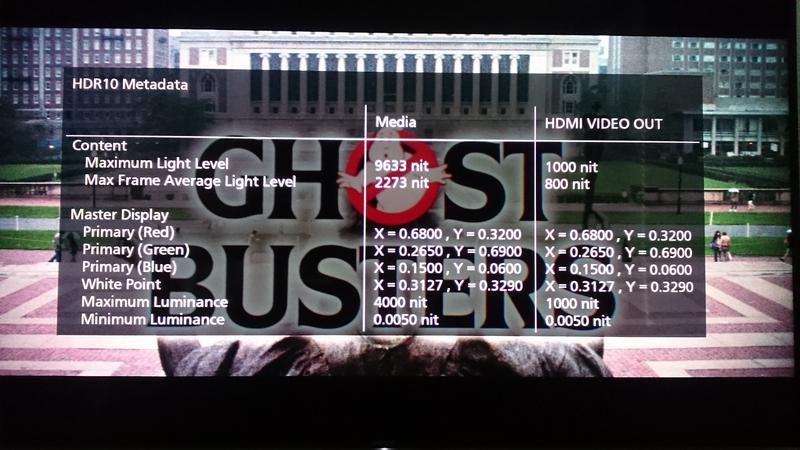

DJR662 DJR662 is offline
DJR662's Avatar
but I'm still looking to find out what the Ghostbusters movies are reading for the metadata, not just the two older movies but the newer one as well. Can anyone help a Geoffy out?
Optimizer on (Middle/high luminance).
Optimizer on (Super high luminance).
Optimizer off.
I'm still having the same issues after the most recent update, I was hoping that would be a thing of the past.
Sometimes when playing UHD discs, HDR is not being recognized/shown properly (washed out picture). I have to stop the movie and start the disc again in order for it to display the picture correctly.
Also my player sometimes freezes during the boot sequence after turning it on. It won't get past the "welcome" message on the front display. Have to unplug the power, sometimes more than once. And sometimes the player won't even turn on, not by the power button on the remote or the one on the player itself. Have to unplug the power cord and then hope it gets past the "welcome" message after that.

Old 03-29-2019, 11:01 AM   #3334
Geoff D Geoff D is online now
Geoff D's Avatar
Swanage, Engerland
1348
2525
Thanks DJR. Christ almighty look at those brightness figures, it's as we've been saying in the software threads: Sony do love to blast the shit out of their catalogue HDR grades.
