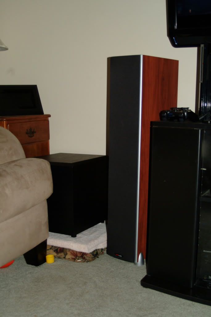

So what do you guys think of my poor man's DIY sub riser?
I had to test it out and see if it even made a difference before I started building one. I was pretty impressed with the change so I think I'll try to put one together this weekend.
LOL - LOOKS GOOD TO ME! I'm sure the "real" one will hopefully work as well...
If you can make the legs longer (4"-5") and increase the distance between the driver and the floor, it may help the sub's performance. Look at Post #1 and see how I added longer legs to my Hsu cylindrical subs.
Also, if you move the sub slightly away from the wall and other furniture, it may help. Give it some breathing room.

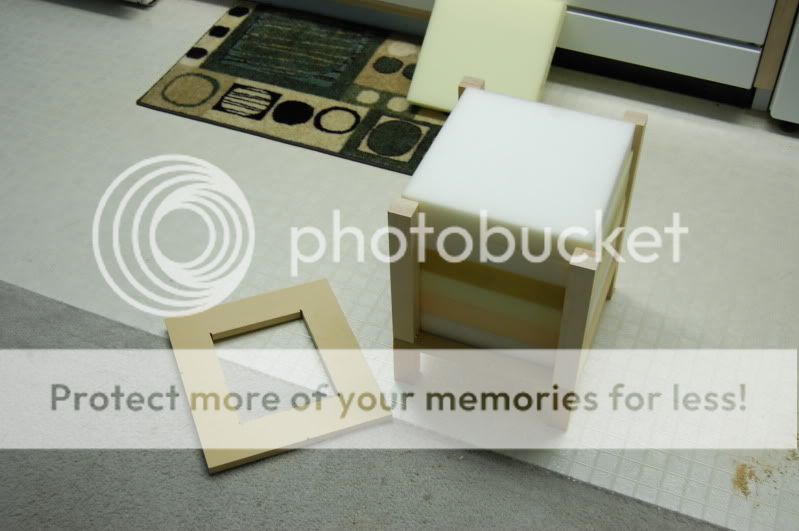

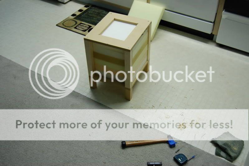

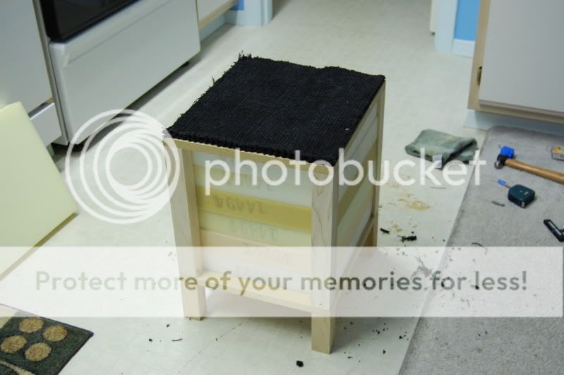

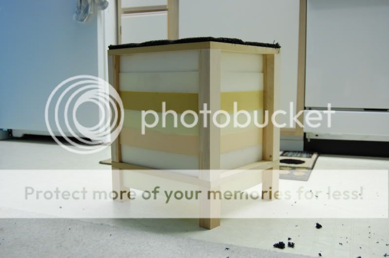

Built A GRAMPA for the PSW110 this weekend
This is the new version of A riser & I got to test the dual front subs today & they do sound great in the spot I have them both!!!

Looks good crazy...was your goal to get both drivers at the same height? Because they do look like that now. I like the idea of further dampening under the riser platform. It's just too bad the legs are not longer on the sub itself, huh? I love the new riser, however, I don't see a small boxer dog or elephant any longer in your set-up? LOL!!!

Thanks forsberg , Really just wanted to get it up off the floor . With the top level of the riser cut out & open to the foam directly , There might not be any reason to rise the sub up off the riser itself !! No dogs this time

CrazyBlue,
You should quit your day job and go into business of making risers.
Looks really good. They can can easily compete with the $400-$500 SubTraps from ASC.

Originally Posted by Big Daddy View Post
CrazyBlue,
Thanks Big Daddy ! How the covering goes on needs to be worked on but all in all piece of cake . With the center of the top level cut out , I think it did have an affect on the way the sub sounded Still being close to the riser itself .

There is no patent on it duneaholic . Feel free , I put pics up so people could see how I did it & Build there own ! Good luck with it !
The only constructive comment I have is to make the surface area a little bigger. You don't want the subwoofer to fall off the riser during big vibrations.
You're right Big Daddy , Guess I wasn't thinking about that . I will keep an eye on it over the next few days then I will be moving them around ,They do sound great where they are . I thought they would hurt the center but they did not !
