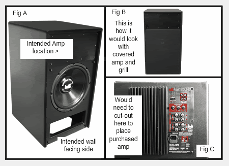

Default Seeking your Opinions
I would like to get your opinions on this as I prepare to build my M&K sub.
Please help me out, what do you think?
Facts:
- The cabinet was made for a "professional series" sub which intended on housing a longer/narrower amp (not available anywhere) on the side where the front firing driver is located. The sub was intended to fire directly at a wall, hence the amp is located on the side of the driver. Look at Fig A below.
- To install new purchased amp, I will need to cut-out the clean side - Fig C.
- Fig B shows how the sub would look with the grill on, notice the covered hole where the intended amp would have gone.
Issue:
I was thinking of not cutting the openning at all, and instead making a separate enclosure for the new purchased amp. I would then place the amp separately/next to the Sub and simply have umbilical-like wires connecting the two, at the bottom of the enclosure.
Pros:
1. I hate the idea of cutting out the nice clean side of the enclosure. Also I am not crazy about the look of having the grill below the closed off openning of the intended amp location.
2. Since the cabinet was made for the "professional series" sub, I like the idea of having it fire towards the wall and using it as was intended. Also, I like how clean the sub would look facing the living area.
3. Not cutting out still leaves me the ability to cut out if I decide to.
Cons:
1. The sub is no longer a stand-alone sub and will always need to have the separate amp tag along.
2. I will be limited in placement since I will have to consider where I place/hide the separate amp
3. Extra time of building an amp enclosure, although it will be very quick and aesthetics would not be critical since it will be out of sight.
WHat do you think?
Thanks in advance!
