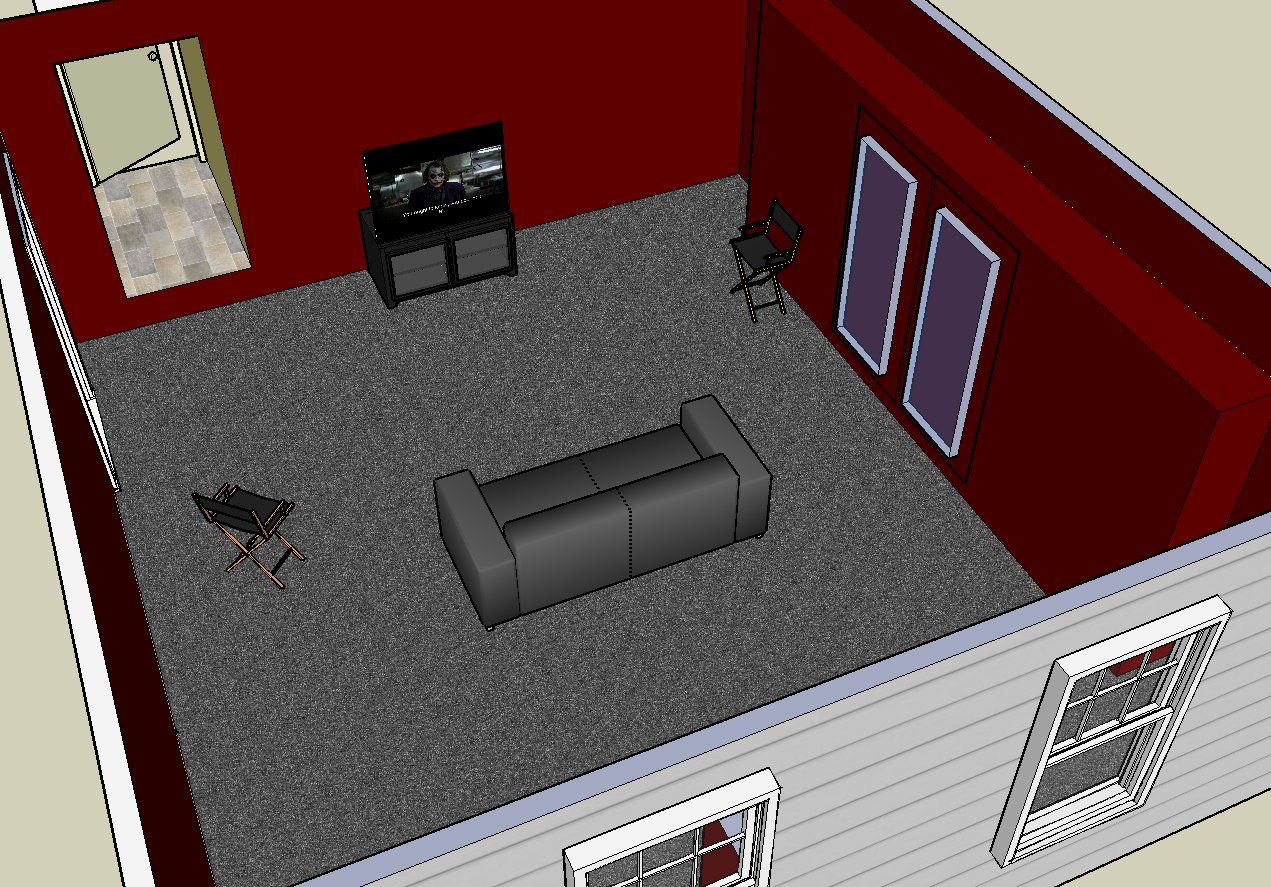

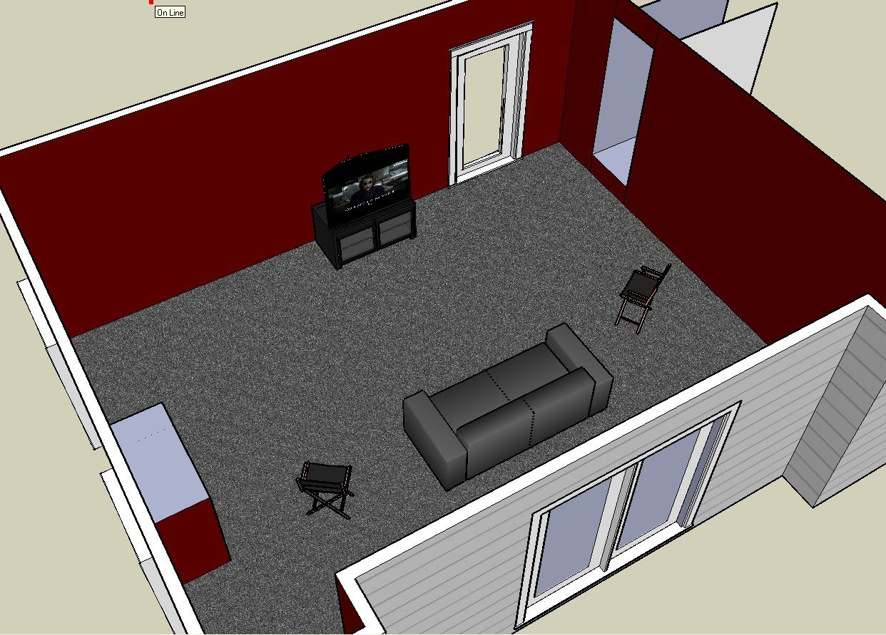

Setup 2(Couch 8' from TV 4' from doors)
Setup 3(couch 7-7.5' from gas logs, 8-8.5 from TV-too close)

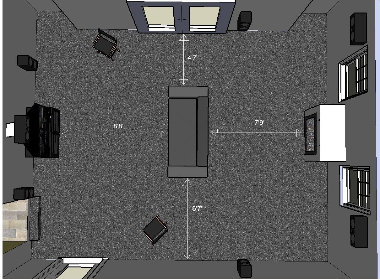

Excellent use of Sketchup! I use it pretty often at work, and it's not only fun to use but can do some really neat things as well.
One question about your future setup...
Have you considered using in-wall speakers?
I think the spacing and location is excellent, but the in-walls might clean it up a bit.

The L/R speakers can go either under each window, or on the outer edge of each window. The Center channel I was thinking if I had a built in or ledge just under the TV it could go there.
Example
Good use of diagrams before building it. That is very commendable and better than most. I just have a couple of suggestions you might want to consider.
1. If you're building shelves to house the equipment under each window, I'd place your bookshelf speakers on the shelf instead of mounting them to the wall. I think you'll find the sound will improve noticeably if you push the speakers forward and have some distance between the back wall and your speakers.
2. It is what it is, but I don't think you'll be very happy having a DLP rear projector sitting above your fireplace. While DLP rear projectors maintain a fairly wide viewing angle for good contrast, it drops noticably when you move up or down in the viewing axis. DLPs should ideally be placed with eye level equal to the middle height of the screen.
3. I would suggest giving Darwin316's room placement idea some thought. Rotating the room orientation and placing the TV and gear on the right side wall will alleviate a lot of potential problems. That room layout is very similar to my first floor den, and that is how I have my 2 channel setup and 32" LCD oriented. You'll have a better chance of managing lighting control, heat issues, and the placement of the TV and speakers.
Good luck. Keep us posted.

I didnt even think about the DLP viewing angle until mentioned earlier in this thread. I am leaning either towards flipping the TV to the opposite wall from the gas logs or rotating it to the wall to the right of the logs.
The wall to the left of the logs has a double door entry into the room that I have to content with.

What I'm leaning Towards.
(To the right of the couch is a set of double doors.)
Old 12-10-2008, 05:12 PM   #40
Aerodude73 Aerodude73 is offline
Aerodude73's Avatar
Middletown, RI (MEMBER OF THE "ECPP")™
134
428
2499
Default Nice !!
Now THAT's what i'm talking about! (note: I don't see a "Sub" in the drawing, but i'm sure you are planning to put it, or Them?, somewhere). 8-9' away, a 50" is probably as SMALL as you want to go. If "I" could though, I'd shoot for something bigger if your budget allows. Looks like you're going 7.1 then, right?
Too bad you can't push the couch back but with under 8' to the Fireplace, you're kind of stuck in the Hot Zone
Good Luck & send pics when you can as you progress!
