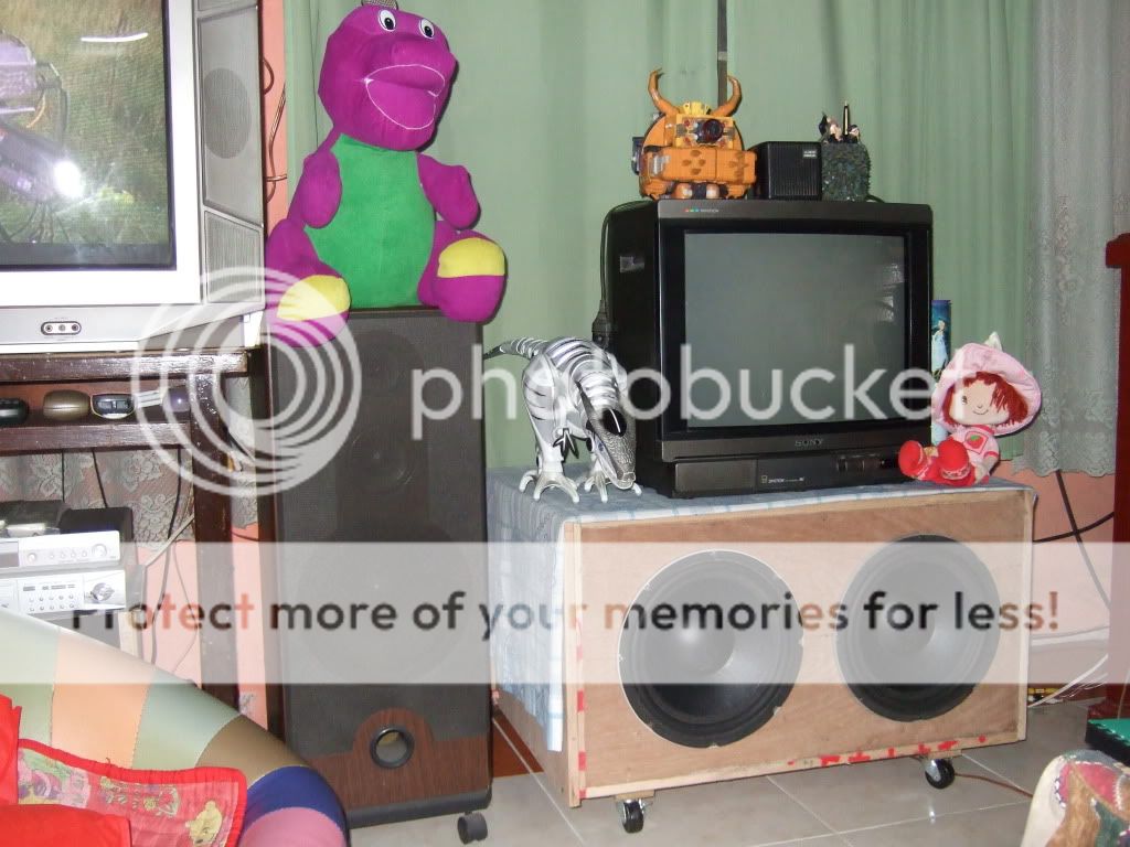

jerix jerix is offline
Aug 2008
Philippines
I placed a heavy object on top to keep him still.
