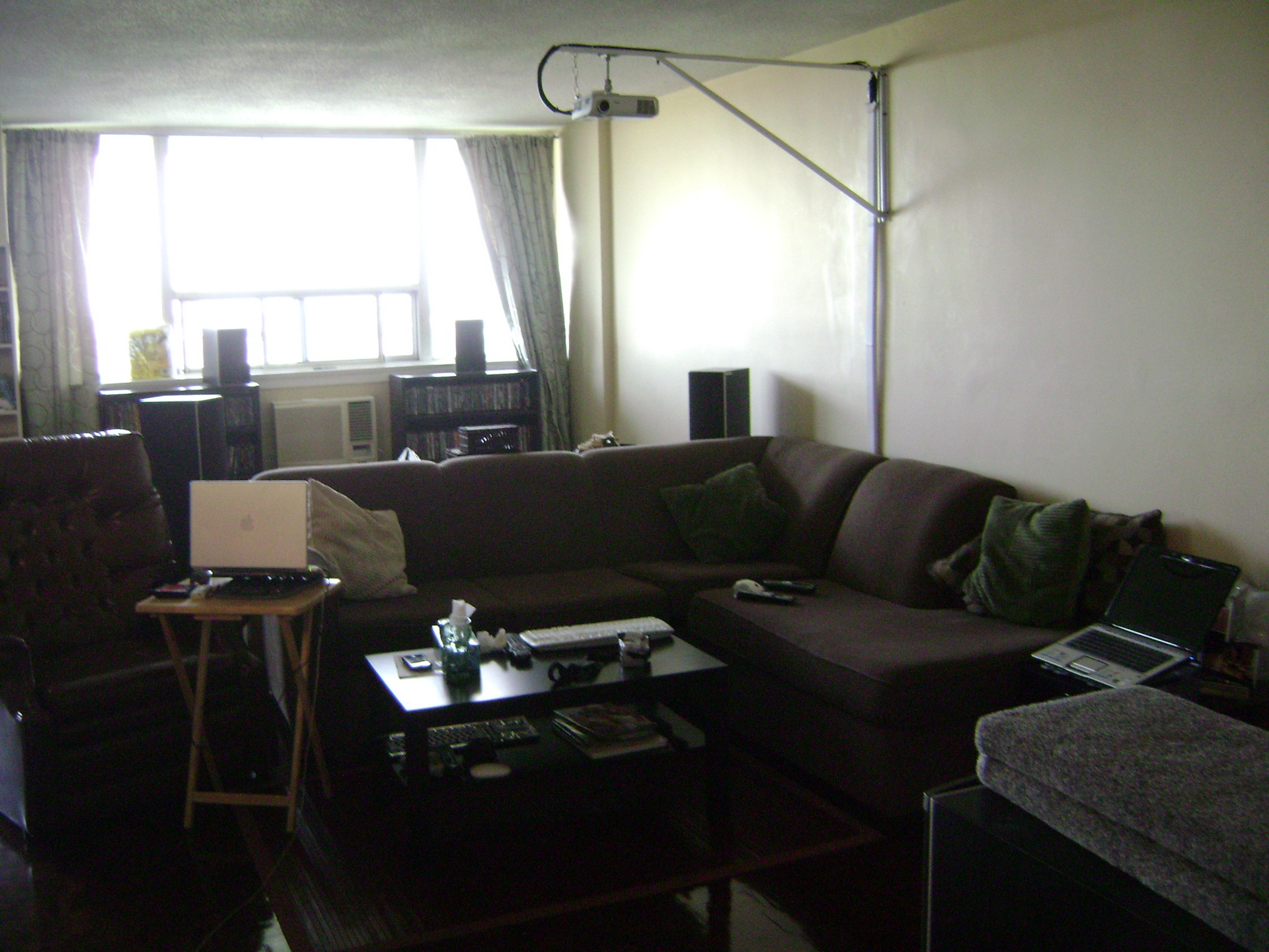

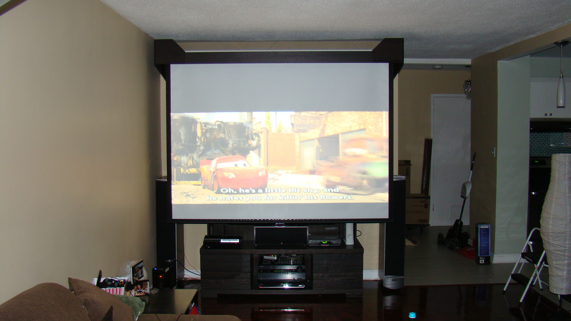

Placement:
Open concept condo
Room is about 25x20
Concrete walls
My Front Left and surrond right are up against a wall (see pictures in gallery)
the backs of my front speakers are sitting pretty much against a wall

Looking at the front image I’d say a lot of the sound in the lows is being wasted and the room ether needs some stud walling knocked that will make a difference.
I bet the if you measured the LCR front you’d see a very uneven frequency response with bass been sent maybe near that front door?
Oh, yes, yes, that’s better now I can see the speakers left/right yeah, that is not a healthy set-up.
The left is near to two wall boundaries the right is partly near wall and the rest is open space!

Yeah just looked at the second picture, sorry I just got home its cold and I’m cranky.
For surround to work surround speakers have to be located on the walls so that your not climbing over them! I’d start with making the room simple straightforward shape because of lot of the lows will be wasted up front.
The whole room is all cockeyed! I take you like the view from the window or you can say (bugger the view, I see enough of the outside when I go outside). You can block the window up and its nobodies business! You can use think MDF then screw attach the back speakers to surface high up so it beams the sound down at you!
I’d use a few more the same smaller speakers for surround they will work in that room.
You need to get look like one shape rather than all those twisted turns. Yes I know it cost money but you want sort it any other way.
Can you please take a few more pictures around the flat so I can get better perspective.

Originally Posted by Cpus456 View Post
My problem seems to stem from a lack of power.
I think the addition on my 2xRTI10's, then the CSI6 have put a strain on my Onkyo.
The unit pushes 90 watt per channel and every channel is being used.
yesterday i was reading that my rti10 are actually 4 ohms [with the straps on(read in a polk audio forum and was confirmed by on tech at polk)
Also my CSI6 is running at 6ohms.
This added stress must be the reason my sound seems err, umm Empty! if thats a way to describe it.
The fullness is not there!
now the solution might me to add an amp to power my 3 front units - but the problem lies in the AMP - no pre outs to an external amp
Should have opped for the 707.
I also read the the emptyness might be due to the fact that im using onlyo with my polks - the onks seem to have that effect on them
Heres some info about my setup
Placement:
Open concept condo
Room is about 25x20
Concrete walls
https://images.blu-ray.com/htgallery/21951_full.jpg
https://images.blu-ray.com/htgallery/21955_full.jpg
what should i do
go the cheap route and remove the straps on my RTI10, disabling one of the 8 inch woofer so they can run in 8 olms and disconnect my two rear speaker and go 5.1?
or
Sell my onkyo and grab a pioneer elite VSX-21TXH and a 3 channel amp to power my front stage.?
or
Emotiva UMC-1 and UPa - 7
Recommendations?
you need an amp, but this model onkyo i believe doe not have preouts on it. i had this model and sold it for the one in my sig. now i am considering on buying an amp from emotiva. more power and they will sound awesome!!
