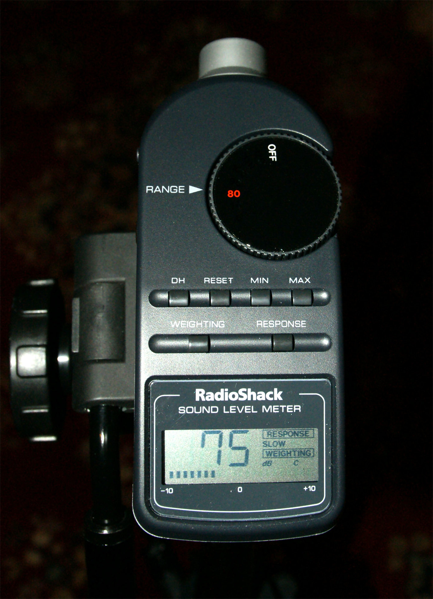

Got the Radio Shack Sound Level Meter and calibrated my speakers today. Treaded into a new experience and was fun doing it, first time effort so was not sure if I will get it right. Surprising enough it was not that complicated. I certainly can hear the difference all the speakers as if woke up and alive. They all are in sync and in harmony

A few things. A SPL meter can only help you set your levels, to do a full calibration you need more hardware. Second, the SPL meter you have isn't completely accurate. You can download the calibration file for it, but then you'd have to use it with some type of measurement software. I completely agree with big daddy, you should pull the speakers away from the wall a few feet if you can. Also you should consider getting some dampening panels to place behind your mains. Having a solid surface like that will cause a great deal of reflections off the front wall, and being so close to the walls will hurt the imaging of your front speakers. Once again I can't argue with big daddy, raising the sub will help move it away from the point where it's adding the most energy to the vertical node in the room.

Quick question, is the SPL meter being run from your listening position?
Also, here are the offsets for the SPL meter you (and I) have:
Yes I had the SPL at ear level from my listening position.
A few final tips, you shouldn't point the mic directly at the source. You want the meter almost vertical, with a slight angle forward between 10-20 degrees. If you can test with out moving any furniture from the position it's normally in when you're listing it'll help. The meter isn't perfectly accurate below 100hz, the offsets can help tho.
Thanks again for all your suggestions. It is amazing how every one is so helpful in this forum. Regarding the direction I had pointed the meter where the wall and ceiling meet. That will I guess be similar to what you have suggested almost vertical with 10-20 degrees ? I will have to recalibrate as I will be moving the front speakers away from the wall and also adding the second sub.
If the sub is the same size and RMS wattage as your current one then you should calibrate each one alone to 6db less then your fronts. The sum of the 2 should bring them up to match your mains. One other thing you might consider is getting a IIR PEQ like a velodyne sms-1, antimode or if you're adventuress a BFD. It helps level out the LFR in the room.
