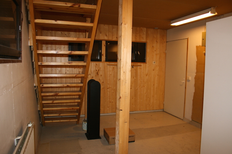

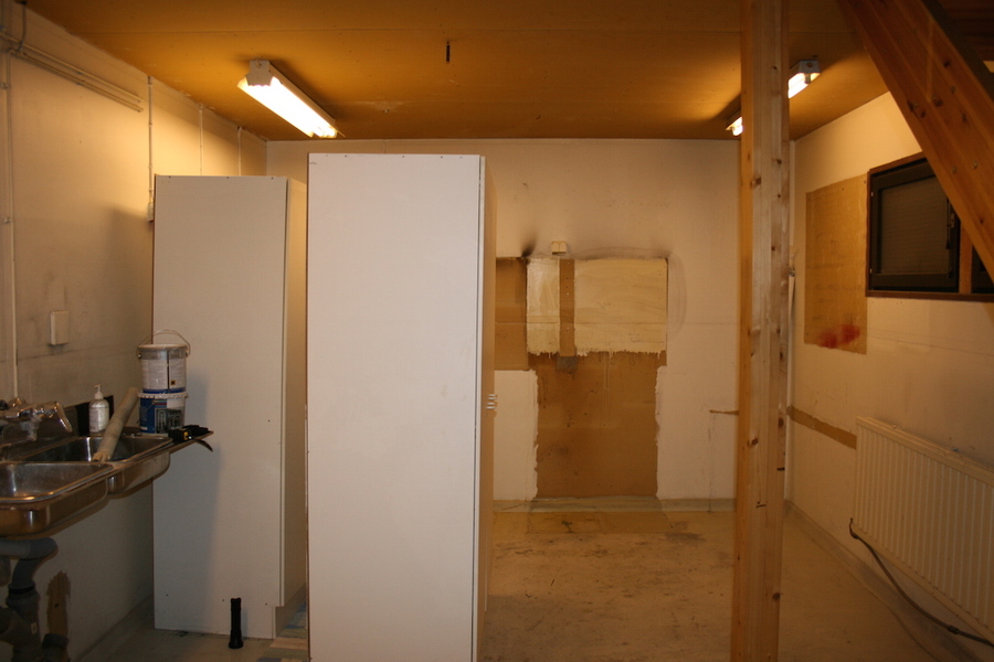

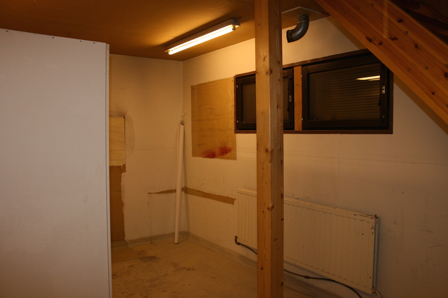

Here is some "before" pictures:
Picture taken from entrance. Radiator, sinks and fluorescent lamps are going to be removed.

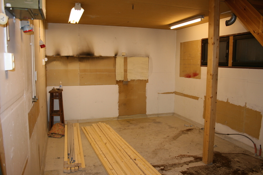

Picture taken from screen wall. Here you can see where garage doors used to be.
All windows are going to be covered under new wall material.
October 24th 2009

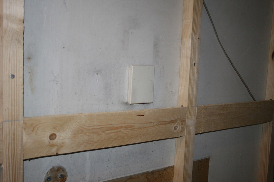

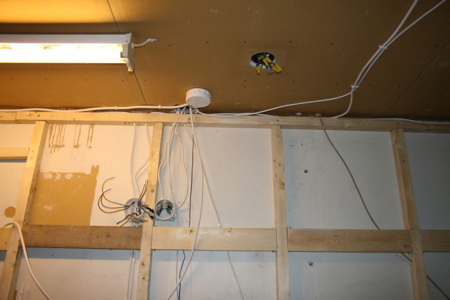

Radiator and sinks removed. Also some old electric cables removed and that old fuse box is next on the list.
Future home office is also under construction. All septums removed. Also wooden wall panels need to be removed.
Some work for new walls and electrics is already done.

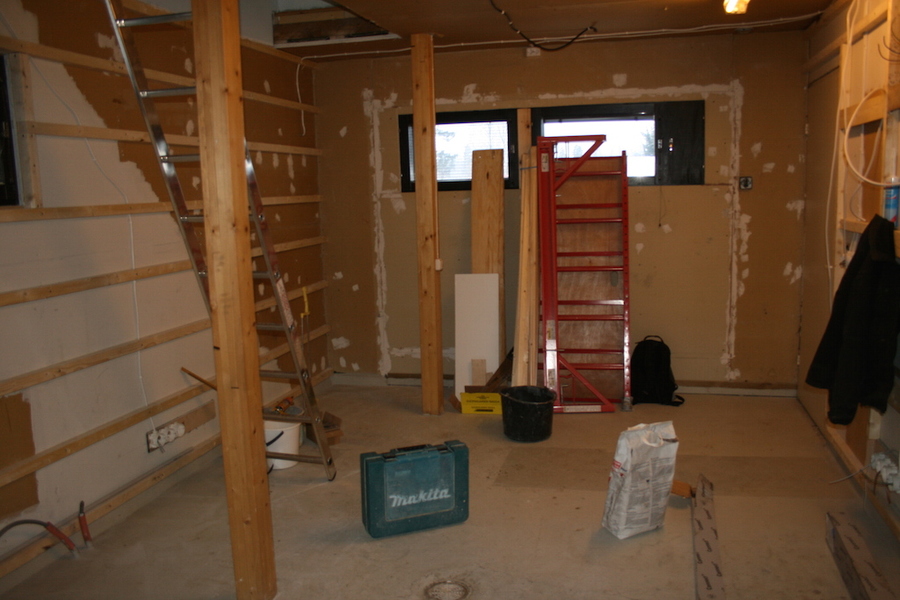

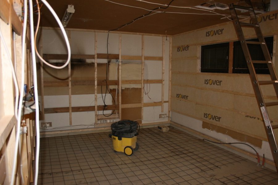

March 16th 2010
Stairs removed and some work done for walls.

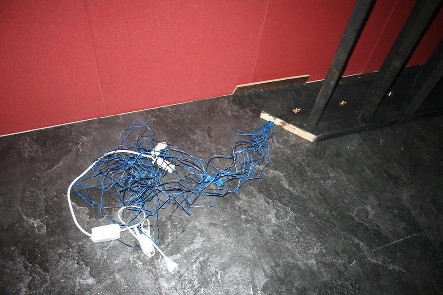

Some of the numerous cables running through theater.
HT is equipped with "central vacuum system".

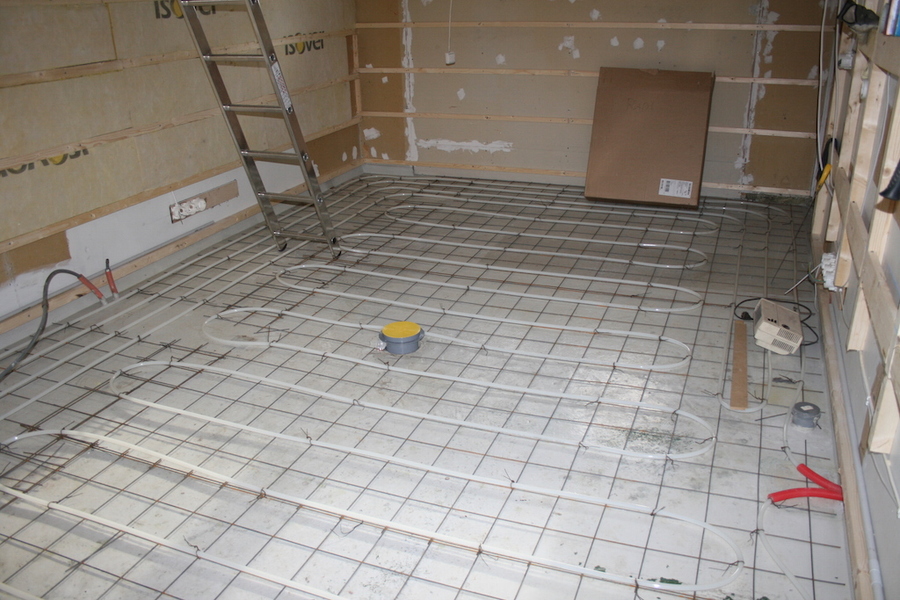

Water pipe installed for heating purposes. 100 m in total.

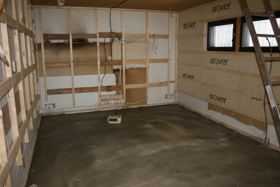

March 21st 2010

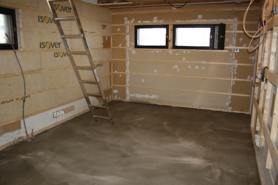

New concrete floor added 80 mm.
March 24th 2010
Glass wool added to walls.

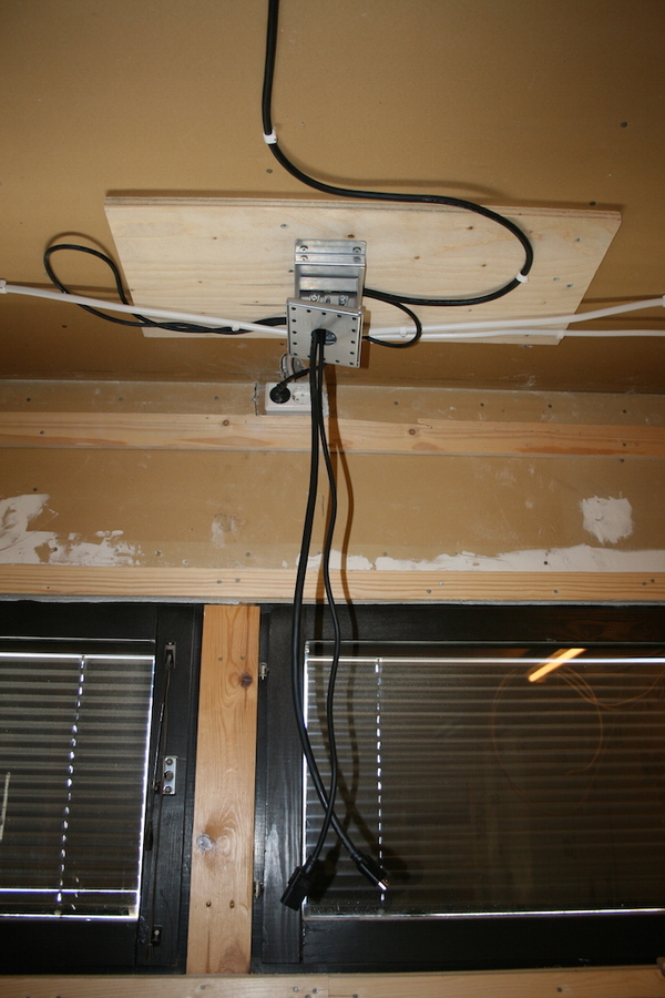

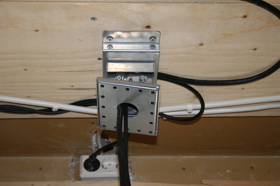

Projector mount.
Projector mount installed.

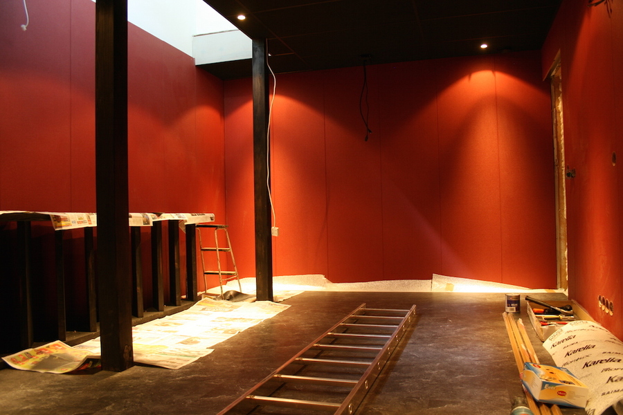

Supporting pillars and some new wall panel installed (Halltex Taika 04).
March 26th 2010

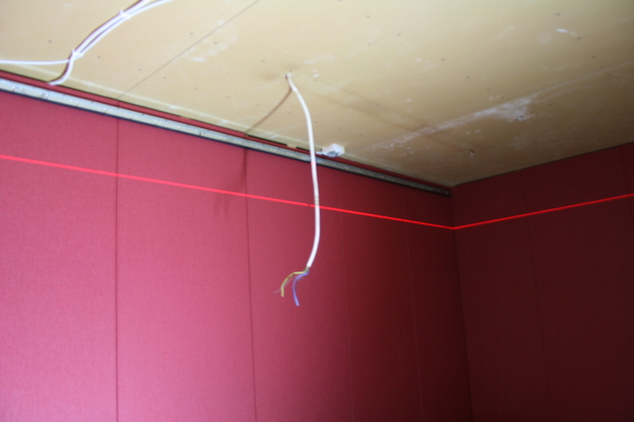

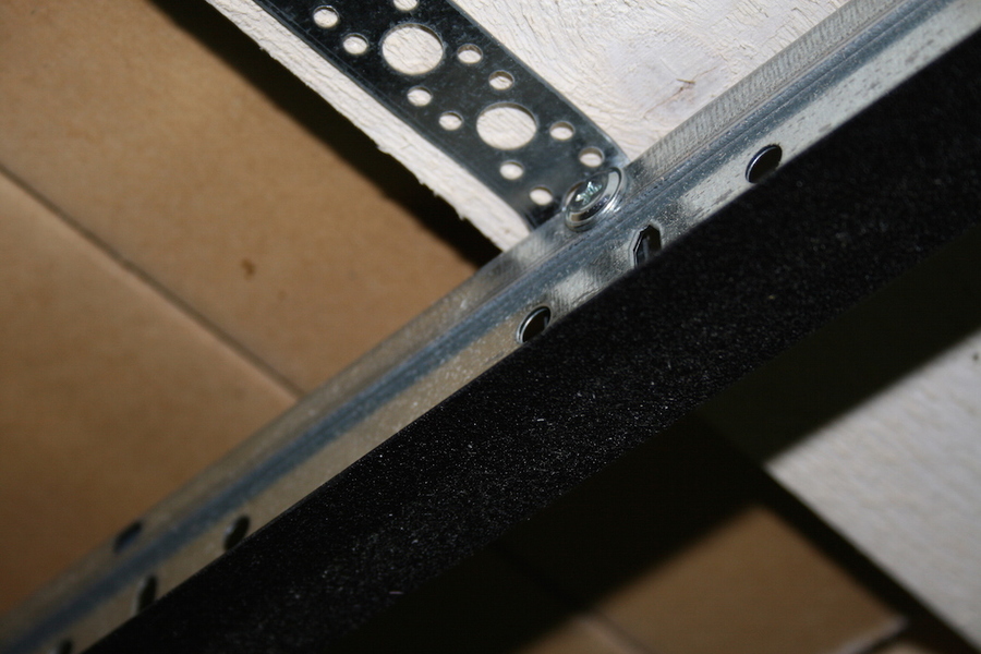

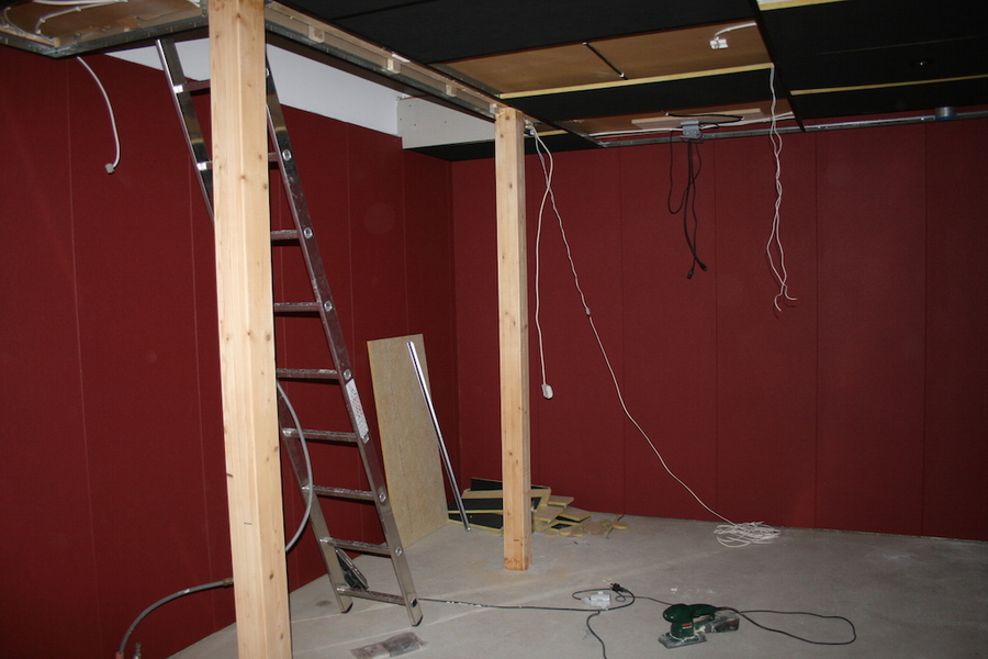

Ecophon acoustic ceiling needs some rails.
Laser for wall ceiling installation.
Close-up of rail installation.

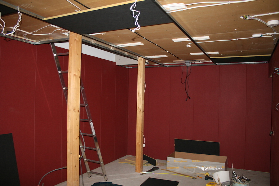

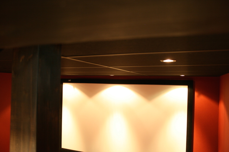

Some Sombra A panels and halogen spots installed.
More ceiling rail system.

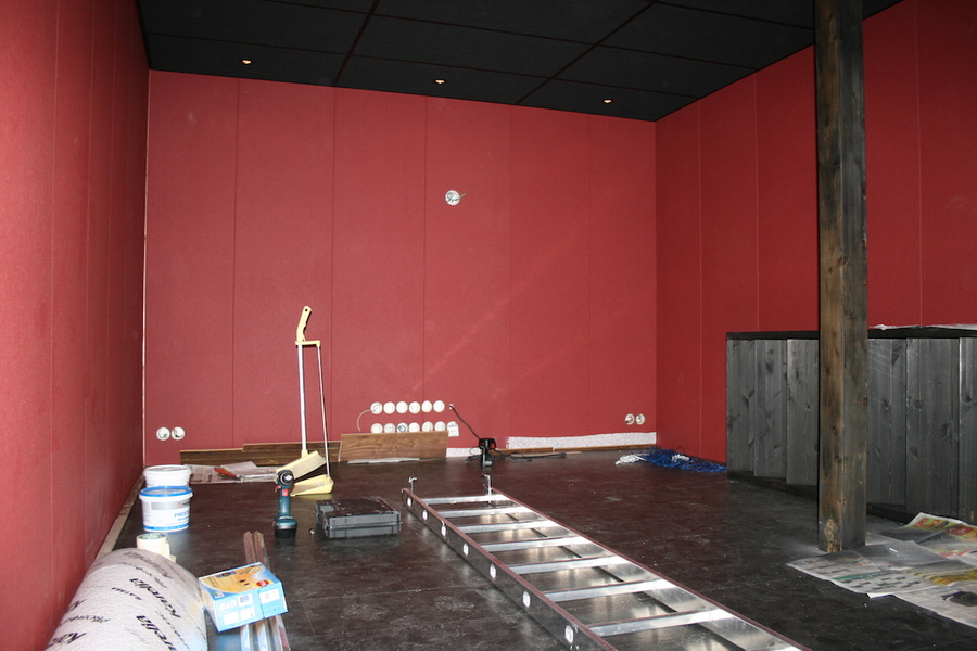

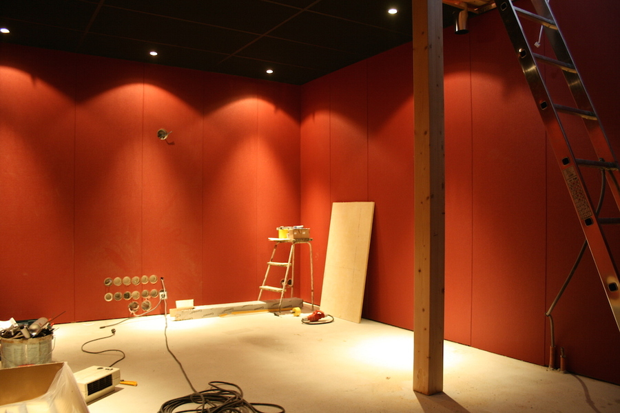

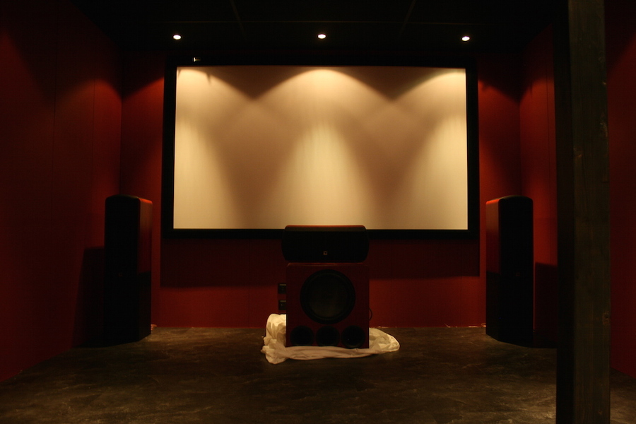

March 29th 2010
First group of spots in action.

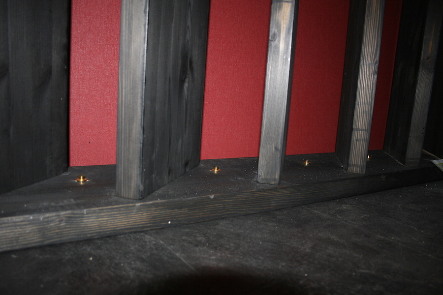

Pillars are grinded and ready for some black stain.
