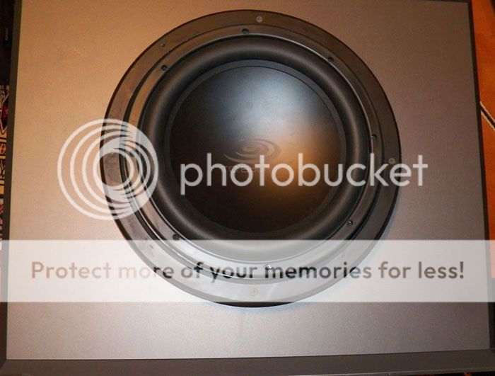

The cutouts on the cabinet were for the 8 ohm Dayton Audio RSS315HFA-8 12" Reference HF Drivers. There is also a cutout for a Dayton Audio SPA1000 1000W Subwoofer Plate Amplifier. I decided to buy the better TC Sounds subwoofer drivers. They are slightly bigger than the Dayton drivers and require a bigger cutout. I decided to use two quality 12" inch spacers from RT Mobile Sound System. They make some of the best subwoofer cabinets for cars. I also covered the cutout on the back of the cabinet for the amplifier.
This is the picture of one the TC Sounds drivers attached to the cabinet using the above spacer ring.
The Dayton drivers were meant to be connected in parallel to result in a net impedance of 4 ohms. The single plate amplifier was expected to drive both drivers. The two TC Sound drivers use dual 2 ohm voice coils. I wired each one for an impedance of 4 ohms according to the following diagram. For explanation, refer to the Connecting Dual & Quad Voice Coil Subwoofer Drivers to a Mono Amplifier thread.
Also, Big Daddy does not believe in wussy plate amplifiers. You can ask the former employees of Elemental Designs why plate amplifiers suck. My intention was to use the Upgraded Carver 1.0t Stereo Amplifier to power the two drivers independently. The drivers are not connected to each other. The upgraded amplifier can generate up to 510 watts RMS (1000 watts dynamic) power into a 4 ohm load. Each channel of the amplifier will be used to power each driver. The amplifier was upgraded in Nebraska and its performance has significantly improved.
