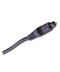

Originally Posted by CantFeelMyFace08 View Post
I know this may be a dumb question but what exactly is an optical input?
this is an optical input (not the best picture)
and this is an optical cable...
the only way you will get surround sound with your PS3 and System is through the optical cable.
are you are using the Samsung HT-TX72 5-Disc Home Theater Surround Sound System? (yes it does have an optical input)
