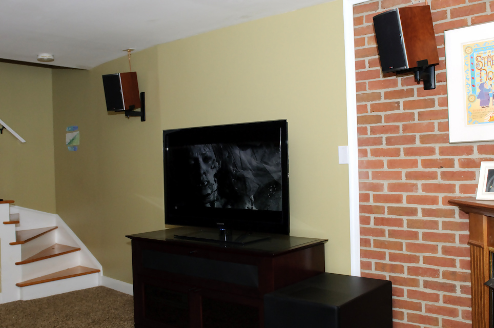

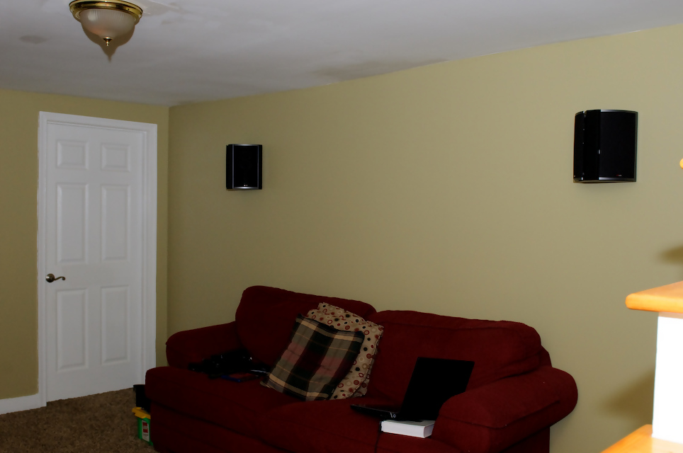

I was in a similar situation for my surrounds. I am using Polk Fxi3's in bi-pole mode.
My fronts are elevated to the ceiling due to young children. I am hoping to eventually move to towers.
As far as the sub, I have neard corner placement usually gives the most bass reproduction. I just have mine to the side of the cabinet. I am considering moving it next to the couch in the future.
