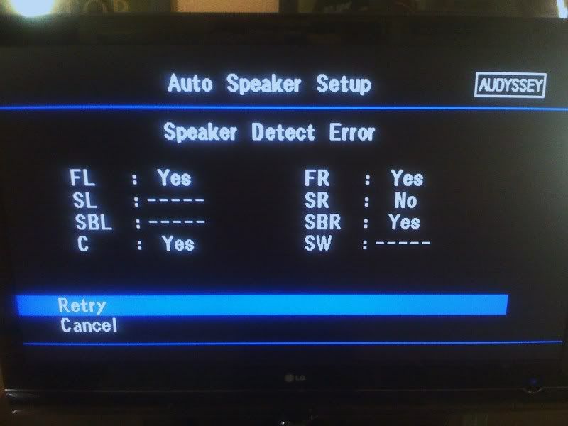

one more thing,i ran the audessy test again,
i took a picture of the error message, hopefully that can make things make a bit more sense.

Originally Posted by Tom Bars View Post
with the surround right and left nothing came out, but when i scrolled over surround back left and right sound came out.
You need to connect the surrounds to the SURR Speakers connections not the SURR Back Speakers connections.
Then re-run Audyssey.
There you go.
SL and SR are the 2 that should be hooked up.
SBR = surround back right. you don't want that connected. its for 7.1
edit: Surround Left is blue. Surround Right is gray. do not connect anything to brown or tan
