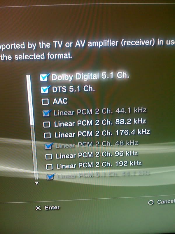

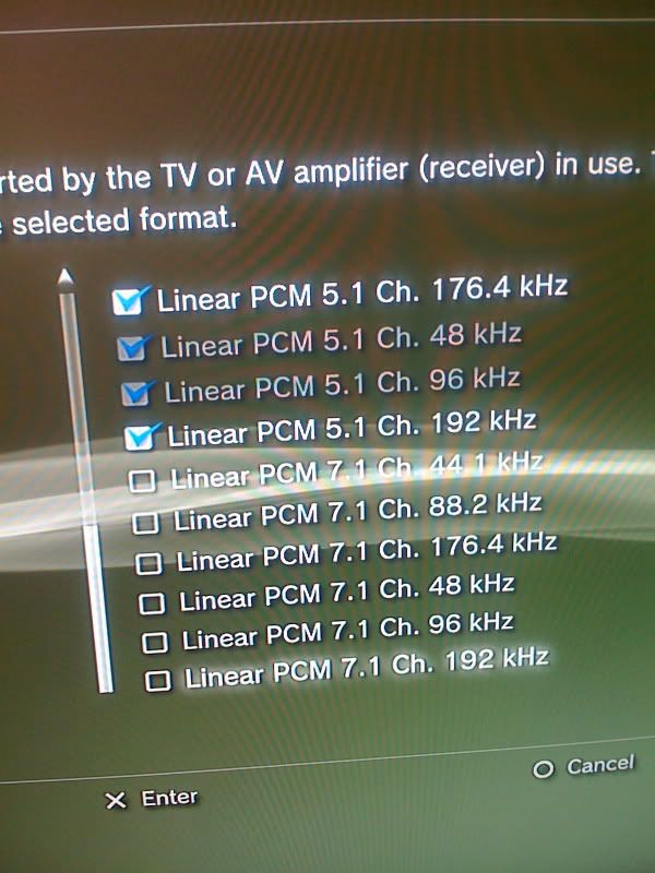

pretty sure everything is working, the audessy didnt come up with any error messages, and i just turned off some Ps3 settings, let me know if i did this correctly. thanks

Glad you got it sorted out. Personally in the PS3 I would let it do the setup automatically and leave it alone after that. If you watch a movie with 7.1 (Hellboy II for example), the receiver will account for it and combine the surround back audio channels into the surround channels in your 5.1 system so you won't be losing any sound. There's really no need to un-check anything.
