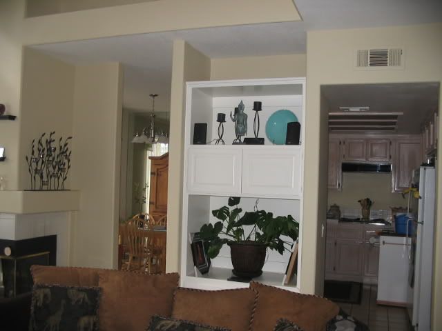

what would happen if i placed a sub in the spot where the plant is... right below the surround speakers.
i have just came from HSU and demoed a few subs and the subs they had in their room were located directly behind the sofa..
liking the sound i was wondering since this is the only way i can place a sub behind me...
how will this sound.. ?
how will it sound for a downfiring sub with a rear port?
a forward firing sub with a rear port?
forward,, with forward port?
forward with downward port?
im sure each option will yield different results since the area the enclosure will be in is and enclosure itself.. just open on one side..

I hope you mean the floor behind the couch? I am almost certain you do not want to place the sub on the shelf behind your ears for various reasons. If it is on the floor behind the couch, then all I can say is that from what I know, placing a sub behind the couch under the plant area would basically require you to have 2 subs (one within the front soundstage area and the one behind the couch to properly fill the room with even bass. I do not think that one sub behind the couch is going to give you what you are looking for. As for one on the shelf......I'll leave that to the many better expert members we have here to explain in better detail why not, than I can.

trust me i understand what your saying.. also that area is about 3 feet from the rear of the couch..
and if i hadnt seen it for myself at HSU i wouldnt think it would work being directly behind the couch... but they had all the subs in the demo room behind the couch... nothing in front..

All things considered, subwoofer location behind the couch is not the only consideration, even though you saw and experienced a nice demo with a sub behind the couch. Whole-room configuration (location/angle of walls/doorways/openings, acoustically live/dead wall/floor/ceiling surfaces, etc.) will impact the best sub location more than most other factors.
My living room has challenging acoustics to it. I have tested my subwoofer in various locations, and if you look at my gallery, you'll notice that you can't see the sub anywhere, except for the direct shot of it. It is actually off to the side of the couch, against the wall. One of the places I tried placing my sub was - you guessed it - right behind the couch. Did not fare well there - too much cancellation. Where it sits now, however, the sound is very good.
Why not try it with your current sub and see for yourself? There's nothing better than a little enthusiastic experimentation, and you never know! It might be an optimum location with your room geometry/materials. With your sub right behind your heads, and providing solid LFE from there, you might find the sensation of LFE a little more noticeable.

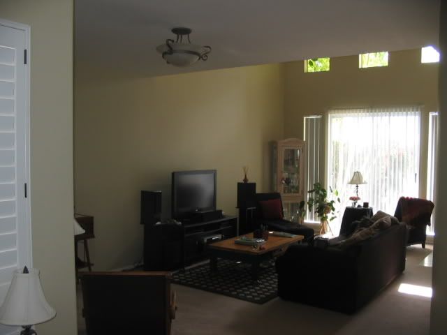

That looks like a vaulted ceiling....so that is one big room. How do you feel about that part of your room? With audio, it's all about how you hear it as it is your set-up, but with one sub behind the couch and a room that size....I just don't know...?

i will give it a try with my current crappy sub... it is forward firing with a down port... but that crap only extends to 44hz..
I KNOW,, I KNOW..
my initial plan was to go with dual subs on the sides of the tv stand... but i just wanted to get others reactions to the cubed area behind the couch...
so far.. before i was running my sub way too hot... didnt realize it.. doing so to get some low end... but now that i have it calibrated it is about 6db or so higher than the rest of the speakers... atleast now i dont get that extreme low bass while sitting in the loft.. bass sounded louder and lower in the loft than in front of tv... yes i know .. bass waves had chance to complete themselves..

Don't get fooled by the demo. Their rooms are probably treated well and the acoustics measured very carefully. You are not going to get the same effect in your living room.
My recommendation is to get two subs: a bigger sub and a smaller sub. Put the bigger sub up front in a corner, a few feet away from the walls and put the smaller sub behind you. Adjust their levels very carefully so that one sub does not over power the other. This way, the bigger sub will give you deeper and lower frequency bass sound and smaller sub will give you upper frequency bass sound. You will go deaf in a couple years, but you will live in BASS HEAVEN.
I believe Hsu Research makes a small sub for this purpose.

Always put the sub on the floor.
As far as having a single sub behind the couch I don't think you could say that it couldn't work depending on the sub and room layout. It also depends on what you want from the sub.
Like forsberg21 said you would have more chance of covering the room with even bass with two subs in different positions.
But, it is more about finding the right position (or positions if you have more than one) of the sub for your room. You can reduce the peaks with filters, but the nulls will only be fixed by placement. You just have to experiment with placement. If it is about WAF then find out all the places she will accept and try them all...
Do try to give the sub some room from the wall. I had my sub too close and it was giving me all kinds of problems. It sounds much better after giving it a little breathing room. A good distance is the size of the driver + 1/2 that. So for my 10" I have it 15" from the wall. The subwoofer does not produce a directional sound so you don't need a direct line of sight to the sub. I don't think you want to be sitting right next to the sub.
