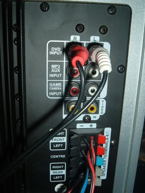

Right heres a picture of the front an back of my 5.1 system. Dont need a pic of my BD player as another poster has already kindly provided us with one
now as you can see there are 2 wires in the back of this red and white...on the other end of these wires there is red,white and yellow connections...iv tried each and everyway to connect these to the back of the BD player and i still have no sound in certain parts of band of brothers. I can hear the music and the action but no talking, yet when i unplug the 5.1 altogether and just watch the BD through the TV i can hear everything

Thats correct yes i wont be getting any sound from the centre because i have nothing plugged into the black connections in the back of the BD player.

Are there any other connections cut off in this picture?
It doesn't look to have optical or digital coax. I don't see any way to connect true 5.1 sound. My only guess is it somehow will matrix two channel out to 5.1. You really need to upgrade to a better AVR/speaker set when money allows. There are a few home theaters in a box out there at a decent price that would give you true 5.1 sound.
