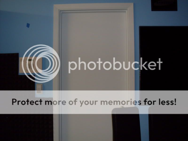

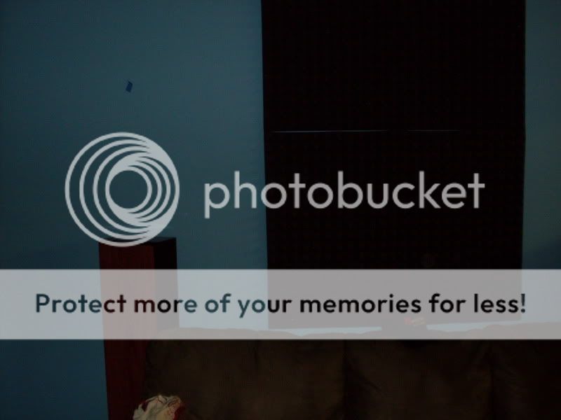

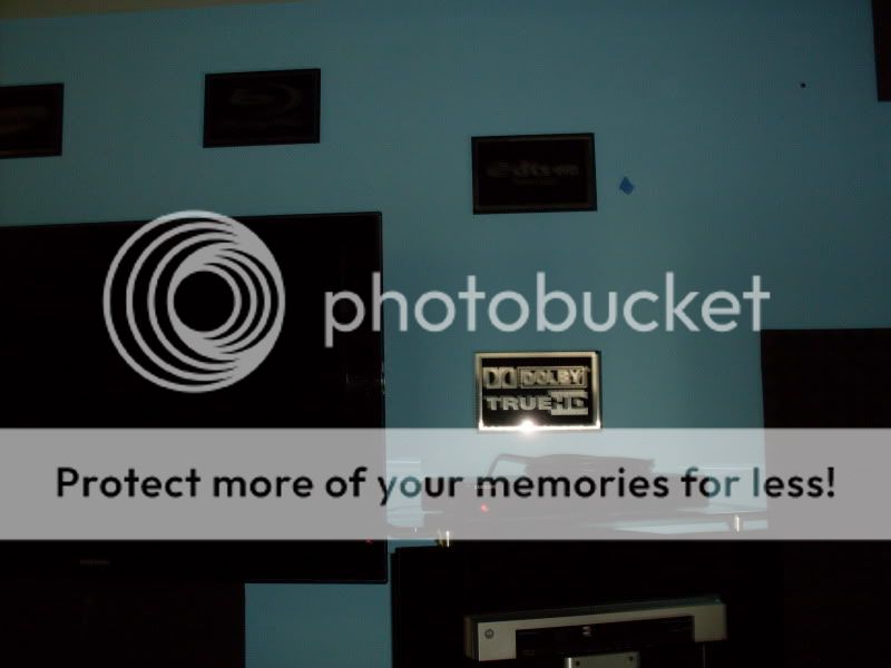

Ok Big Daddy !!! I almost forgot to take pics because I was busy hiding the PINK wire!!!
The only way to have A square is to have it off center to the display almost 2 feet ( front door ~ bedroom door ) The tape is 20 inches from the ceiling & the 125 is 16 1/2 inches tall w/feet !
Sorry they are A little dark !
Perfect square is the best and easiest to deal with. However, if they are in a perfect square, it is still ok. Mine are not in a perfect square, but they still sound fantastic. I play test tones through the subs and walk around the room with my SPL meter. The variation in sound level is less than 4-5dB. Usually, next to the walls, the subs are the loudest.
The key is calibration. Make sure you calibrate each one separately by turning off the other three and measuring the sound level from your listening position with an SPL meter. You should adjust the level of each with the knobs on their back. After each one is calibrated, don't touch the knobs anymore. You should run the receiver's calibration program and tweak the level of all the speakers with an SPL meter.
To get the best results, you need a subwoofer equalizer like the Velodyne SMS equalizer/analyzer. See the sticky thread on the Velodyne in the Subwoofers section.
Thanks Big Daddy ! My crazy head is getting closer to just doing this ! I WILL BE THE CRAZIEST ONE OF ALL TIME ON Blu-ray.com !!!
