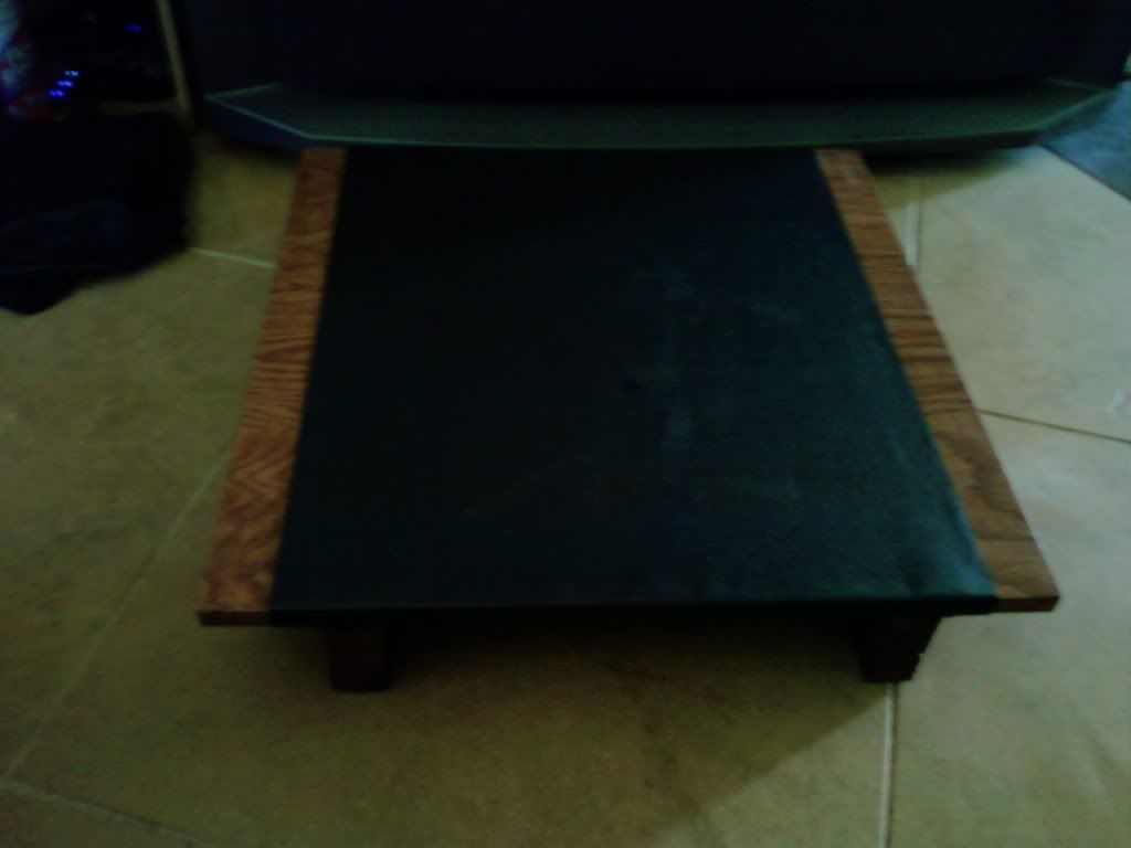

Waiting on an A2-300 and I built a riser to help the time pass.
Old 08-03-2009, 08:21 PM   #583
Big Daddy Big Daddy is offline
Big Daddy's Avatar
Jan 2008
Southern California
79
122
Looks good. What kind of wood did you use?
Old 08-03-2009, 09:40 PM   #584
rmcdermid rmcdermid is offline
rmcdermid's Avatar
Jan 2009
Austin, TX
73
Send a message via AIM to rmcdermid Send a message via MSN to rmcdermid
To be honest it was scrap plywood I had laying around. Should I have used something in particular? Even my crappy sonny that is fixing to go bye bye sounds a bit better now.
Thanks,
Ryan
Old 08-03-2009, 11:24 PM   #585
Big Daddy's Avatar
Jan 2008
Southern California
79
122
Thanks,
Ryan
No, plywood works ok. Put some foam under the riser. You can spray paint it black or cover it with carpet.
Old 08-03-2009, 11:53 PM   #586
rmcdermid's Avatar
Jan 2009
Austin, TX
73
I was debating some kind of acoustic paneling. I have tried to give it a sleek look and it seems some of that foam acoustic paneling would look good and serve the purpose. Thoughts?
Old 08-04-2009, 12:05 AM   #587
Big Daddy's Avatar
Jan 2008
Southern California
79
122
Any type of foam or acoustic panel that appeals to you is fine.
