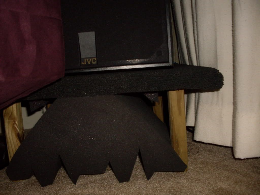

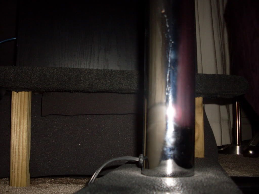

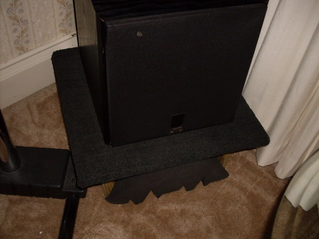

you guys convinced me, and today I sought out the materials to build my sub table. Oak wood 20"x20", cut 8" legs out of material used for stair rungs (don't know what kind of wood), used an industrial type carpeted mat with rubber on the bottom, put some little rubber discs on the bottom of each leg, and then took one of my bass traps and cut it down in size and mounted to the underneath of the table itself. So far so good, gonna experiment further tonight. First thought: seemed like less bass output?..interesting.

Old 03-30-2009, 02:46 AM   #68

yeah, I'll maybe use some different carpet then the stuff I was using to cover the oak, just because of the rubber underneath the carpet, kind of hard to work with. The riser will stay kind of hidden behing the chair, so for now, no one will see it. Same with the butchered bass trap, looks kind of ratty now, but later I'll maybe cover it by running some fabric from leg to leg. Oh yeah, in case anyone else is contemplating this: 11 buckes from Lowes total, one hour to cut all peices and build.
