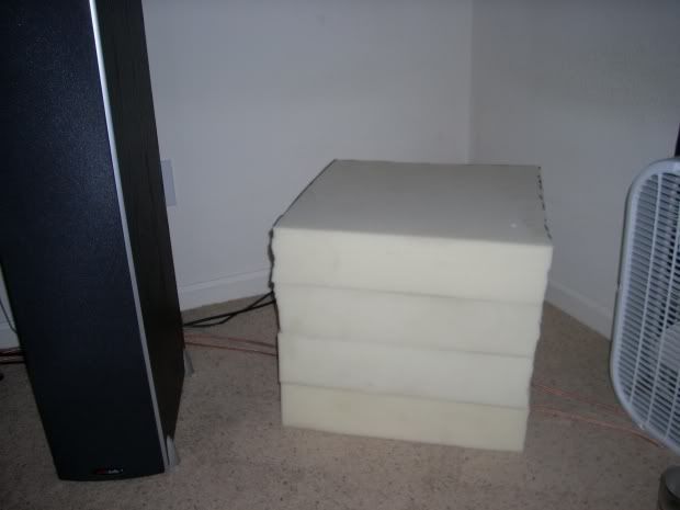

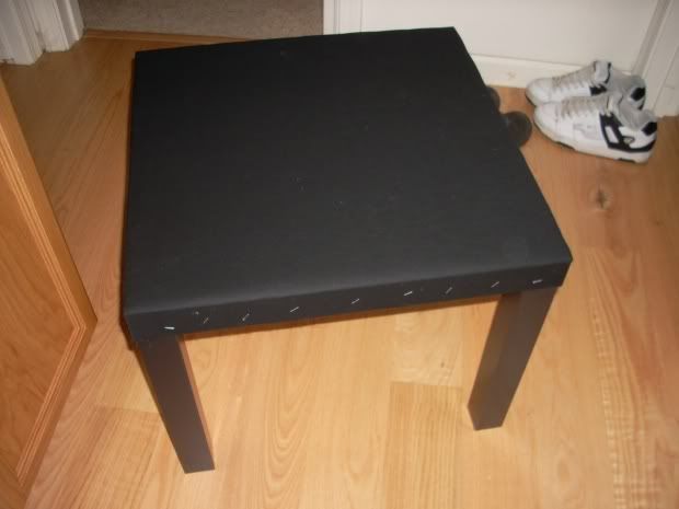

Evenin fellas! I'm almost done with my riser
I have the riser and the foam pieces made, and now I'm trying to glue some fabric around the sides of the riser to finish it off. I read that a few of you guys had used 3m spray glue for your fabric, so I went to Michaels and grabbed a can of spray glue (not 3m, it was $5 cheaper ) and it's not really workin too well for securing the fabric. I did a test with 2 pieces and after it was dry, they peeled apart rather easily. I'm trying super glue right now, but gotta wait for it to dry
Try Liquid Nails, tbizzle. Made a world of difference for me. And a tube is only like $4 at Home Depot.
This is good to know. I was just planning to buy the spray-on stuff that BD recommended, but if this is considerably cheaper...

Originally Posted by fireman325 View Post
I'm looking forward to getting it done and some pics posted.
And it works great! I tried using glue with bad results. On a whim I tried using Liquid Nails, and I was surprised at the bond and how well it worked. And I figured I couldn't go wrong trying it for $4.

I see you don't want the Pieces to ever come off t That is A first on the risers I think
Lol, I want this thing to be solid
Well the super glue worked awesome, as expected. I just ironed the fabric and made a nice hem on the top and bottom, I'll go finish the glue-ing and get some pics

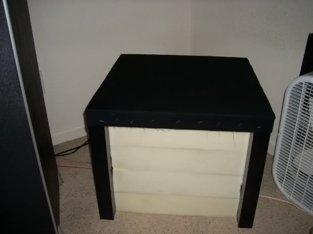

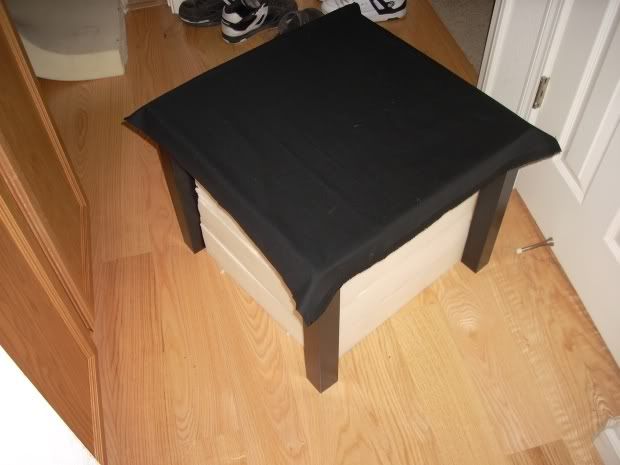

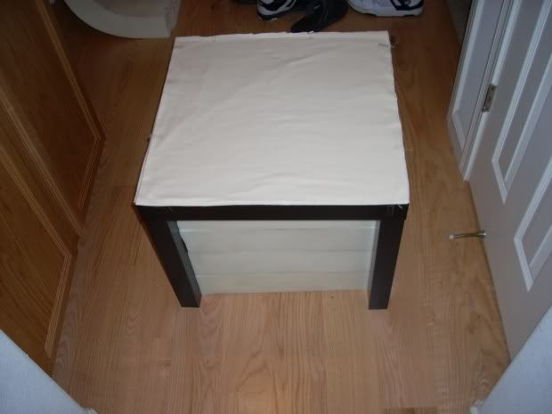

Well, here's some pics. I had to leave earlier, but I taped the fabric in the back when I got home, so this is what it will look like when it's finished. When I finish the back, the fabric will be more taught in the front

Looks good tbizzle!!! Have you tested it out yet?

I second that ~ Look's great t . Let use know what you think & how it interacts with the sub & room .

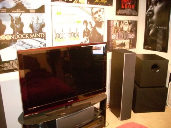

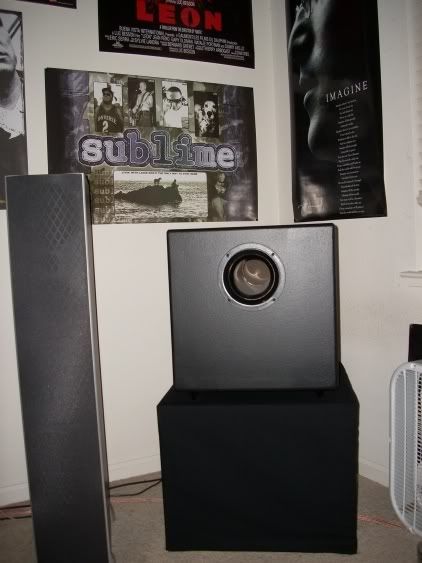

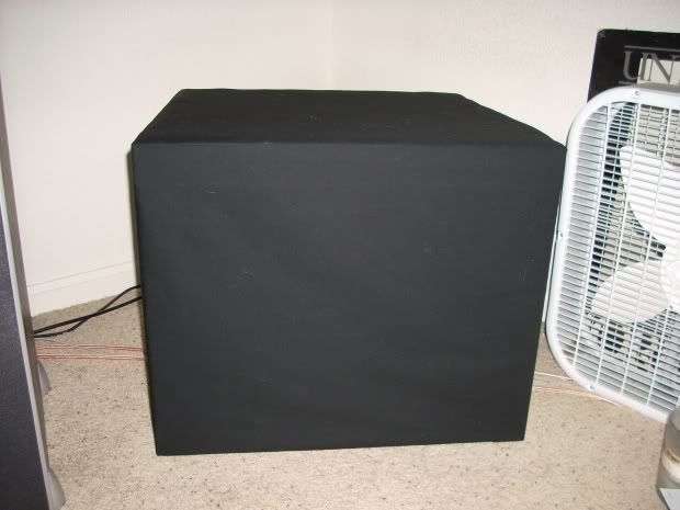

VERY nice! Good job tbizzle!
Thanks!
Here's the final product. I tested a few scenes (Skidoosh, Hulk campus fight, Ben Button sub shootout) and they sounded awesome. Bass was a little more tight, smooth, and a decent amount more non-directional. I'm not an audiophile, but I definitely noticed a difference. It even seems to hit a little harder. I played Beats For My Van pretty loud and my window and door was shaking (as usual) but it seemed to be hitting a little harder, more smoothly and more efficiently
Thanks!
Really looks Great t .
Glad you noticed A difference with having it vs. Not having the Riser !
Where did the Driver go Bud ~ Just Kidding t.
Thanks!
Turned out good t! The only thing left for you now is to order another of those bad boys!
