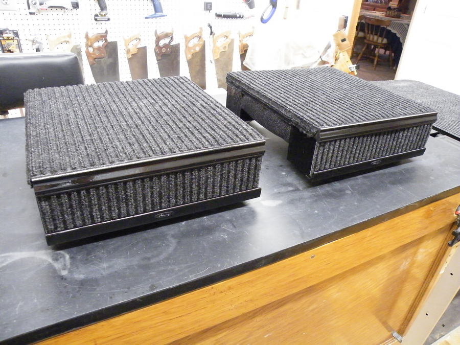

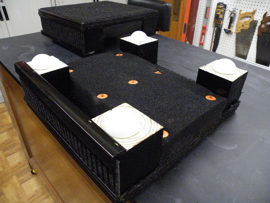

I did something a little different, I'll see how this compares to the risers I built for the HT sub's (first attached pics). I made these for my front L&R speakers in the Great Room, but it will work for a sub too. I built the isolation riser out of 18x11x1.25 Brazilian granite with Dayton spikes.
I'll upload the construction instructions to my gallery.
