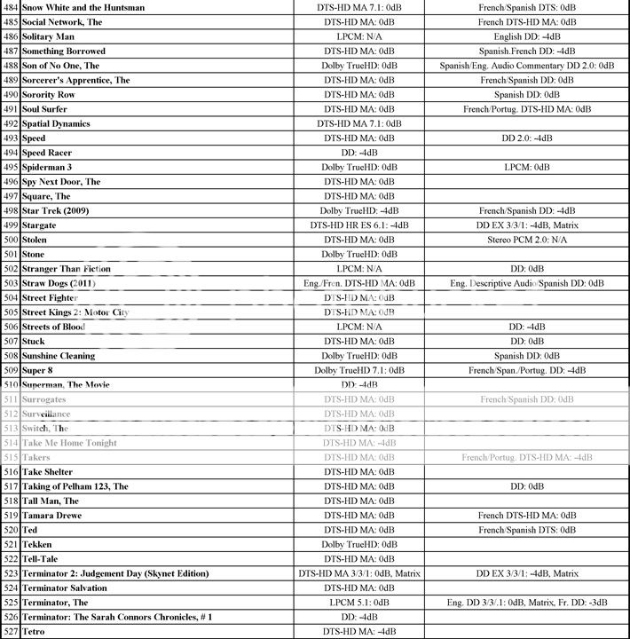

  • Dialog Normalization is not the same thing as Dynamic Range Control (DRC).
  • Dialog Normalization does not reduce dynamic range.
  • Dynamic Range Control is the same as Night Mode.
  • Dialog Normalization does not affect the level of dialogue with respect to the other channels or content.
  • Dialog Normalization does not adversely affect the signal-to-noise (S/N) ratio.
  • The default settings for Dolby encoders is -27dBFS.
  • The default dialog setting for DTS is -31dBFS.
  • DTS soundtracks, unlike Dolby Digital, are not attenuated by 4 dB by the receiver/decoder and as a result DTS movies play 4dB louder than Dolby Digital movies.
  • It should be noted that most THX-certified receivers and processors attenuate DTS movies by 4dB.
  • If you want your receiver/processor to report the dialnorm values, you must set the player's audio output to bitstream. In the Denon receivers, this value is reported in the menu under Information, Audio Input Signal. For other receivers, please check the manual or the internal menu of the receiver.

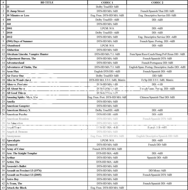

Please note that dialog normalization does not apply to LPCM. It is a feature that was created by Dolby Labs and added to DTS more recently.
It is also important that you remember that BD titles with zero dialnorm offset will play a bit louder. You should not conclude that the difference is because of the superiority of one codec over another.
