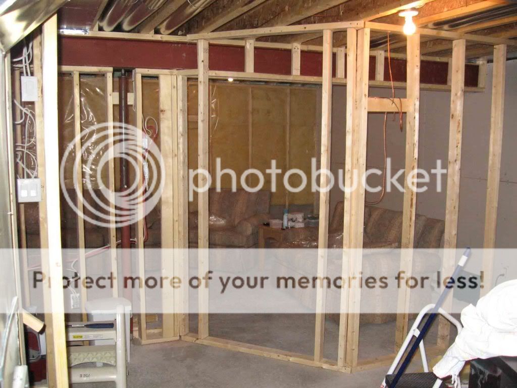

Originally Posted by louhamilton View Post
If it's not a load bearing wall, then cutting one of the studs and putting cross members would be quite easy, especially if the storage area is unfinished.
Oh crap, now that you mention it, it's a support wall for the metal beam that runs across the house.
Metal beams usually do not need a support wall. If anything, they usually have one or two metal posts holding it from dipping/sagging. A wall can be used to hide them, but the wall itself is not usually doing anything for a metal beam.
This the best pick i can find before construction of my HT. That's the only metal post and as far as I was told, the rest of the wall is like a support. I'm not in any way, shape, or form a "builder" or contractor. I just get by with the little I know.

That's what I was talking about. My family owned a construction company growing up and I built my share of houses. What you ar showing in that picture is in no means a wall that has no weight bearing traits. You should be fine in cutting a stud for the 24" rack.
As a precaution (and maybe make your mind at ease), I would add a stud on teh 24" end (in between the stud you would need to cut and the next one). Cut the studs about an inch and a half larger than you need so you can put your "header" and "sill" to the "window" opening you would be creating for your rack.
Again, if the back is open and unfinished, this is a piece of cake job to do.
Good luck!
Good luck!
The back has drywall but it's still bare (no joints, no paint). I will make it a project of mine in a few months since I'll have to buy other wires and such and my cash is all going on gear and furniture right now Thanks for the tips Lou !
