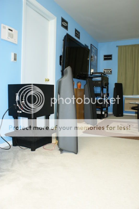

crazyBLUE's Avatar
Aug 2008
Pacific Northwest
89
479
38
Originally Posted by erict View Post
So are you saying, no rubber feet needed? I will be filling the whole box frame cavity completely with dampening material.
erict , the grampa I built has A solid piece of foam completely filling the underneath between the legs ! In fact the foam is about 1/4" taller so the stand is actually compressing it some !
I cannot feel any transfer to the floor even when the sub is doing its job !!
looks good. Do you have any close up shots? Also where and what type of foam did you use?
I just have the 2 pics. of the stand ! The foam is just solid pieces of foam ~ 12" x 12" x 2" thick . I used 3 pieces put together for 6" of foam !!
