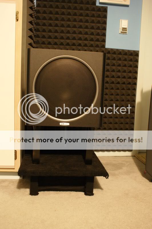

I went to Home Depot to get the little wooden blocks and I wanted to get some type of rubber bottoms to help, but then I came across these
I kinda want to make them a tad bit taller, I'm not sure if I will leave them as they are or glue a wooden block under them to make them a inch higher.
I forgot to mention, they came in a pack of four for $2.28

I just made my own riser for my subwoofer. Does anybody use a riser and if so did it make a significant improvement in the performance of your subwoofer?

I built A riser for my sub ! Yes it improved the sound some . I do think that filling the sub with poly-fill as well as the riser has helped the most on the sub being boomy & muddy sounding !

I made my own sub riser as well thanks to Big Daddy's help. There are pics of mine in my gallery. Yes it will help, it will make the sound louder, even clearer. You also want to dampen the riser as much as possible to help with any port noise, so did you use any carpet and did you attach anything under your riser for further dampening? I noticed improvement in the "tightness" from my sub after building my riser. Also, crazy is right about the use of polyfill as well, it helps to make the sub seem "bigger."
If it helps, I attached a nice post from our own Big Daddy about the benefits of a sub riser, Post #223....
