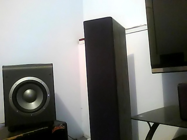

I built my own riser just last week.
It was easy and the price of the material was Very Affordable.
I just got a 2ft X 2ft X 3/4 inch thick piece of exterior grade Birch for the top platform(about $8.00)Then I had Lowes Home Improvement cut me (3) 22inch long 2in X 4in studs to use as legs(supports)for the top platform.
I used Gorilla Glue to attach the (3) 2 X 4's to the bottom of the 2 X 2 ft platform(with the 4inch side as the height and the 2 inch side as the width)Then I drove in (4) #8 (1 1/2inch) wood screws into the 2 X 4's from the top of the platform every 5 inches apart.
So inbetween the super strong Gorilla Glue I have (4) screws in each leg(support)as well.
The 2 X 4's,Gorilla Glue,and screws cost about $11.00(the Glue was most of that,but Gorilla Glue does not play)
Then I covered the top with a piece of Berber carpet I found as a left over scrap at a new home construction site(so it was FREE)
Then I bought about $2.00 worth of foam from Wal Marts Craft Dept(I needed one more bag)and attached the foam to the bottom of the platform,inbetween the legs.
This should help dampen any vibrations and tighten up the low end as much as possible.
I have about $25.00 total in all of my materials including sales tax.And pics are in my gallery under Sub Platform and Speaker Risers.
But considering the low cost and the ease of construction,it is certainly worth every bit of the effort behind it.

Ah, I forget about those. If you were to fill the inside space with insulation and cover the whole thing with black felt- you would have a nice bass trap of sorts with a solid black cube.
You could get two excellent combo risers for like $40. Maybe a bit high for some set-ups. ($20 bucks for you HiDef since you already have the tables. )

Well i just made a riser for my sub, had never thought of this tweak before and i can definitely say it is a big improvement. Raising the sub just 12" off the floor improved clarity and overall performance, the 1 downside is i have to run my setup to re-calibrate my settings, the sub is probably 10db louder on the riser. I would recommend this to anyone reading this form.

+1, I did exactly this and used my SPL meter to help dial it in even further! The difference in clarity and depth was noticeable.
