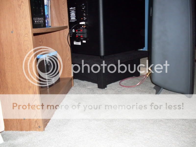

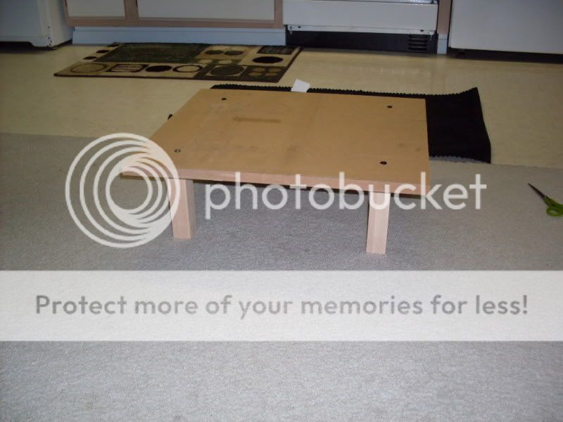

Finished subwoofer stand .
The stand without the foam .
There is A 12" X 12" x 6" chunk of foam covered with black felt underneath the stand !
Performance test in A bit with A movie !!

Good job Crazy. How high are the legs? Remember that we call the DIY subwoofer stands Grampa as opposed to Gramma. Read my post to see what Grampa stands for.

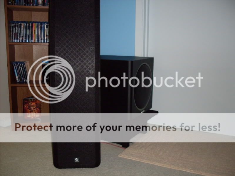

The stand raised the sub 7 inches . I also played with settings during PEARL HARBOR & found out that it sounds much better when the LOW PASS is set around 100 instead of 160 , With volume nob on back of sub set at 3/4 volume!
Of course -15 dbl on the receiver for the the attack was something else!
I've read what Grampa stands for the morning you posted it !!!!!
What kind of wood did you use for the top and for the legs?
The legs are maple & the top is MDF All was scrap from work .(free)
I have the legs on the stand placed directly below the feet of the of the sub so there are no issues with the board itself !!

Do risers primarily help down-firing subs? sorry if this is a repeat question.. I'm just thinking in terms of sub wave output. You'd recalibrate of course, but ultimately how does it help if all else is equal?
No, they help both front-firing and down-firing. DobyBlue has one for his Paradigm front-firing sub. Two of my subs are front-firing and two are down-firing.
If you are having trouble with your sub in your HT room, risers can help. They make the sound louder, more even and clearer. They are so cheap and without any risk.
If you are a do-it-yourself kind of a person, build one or you can buy Grama risers from Auralex.
