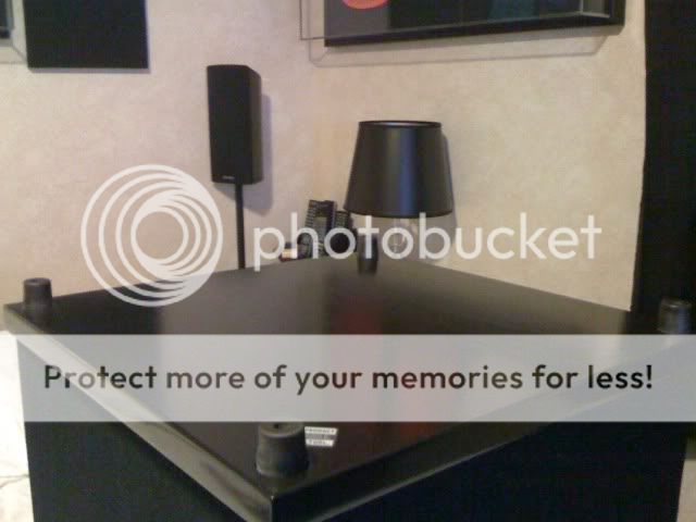

Finally built myself a riser. Big Daddy, let me know if I did it right. Picks in my gallery. Thanks !
Looks good to me I was looking at the floor riser you built and wondered what all the holes are for?
Well done gates ! It close to the one I built for my 110 . You even put A piece of carpet on the floor under it witch is A good thing !
Nice Job !
Thanks ! With the holes it acts as a broadband absorber.
Nice Job !
Thanks Crazy...I was going to just leave it at the rubber feet but then I decided to cut a small piece of carpet. Your sub setup is just out of this world !
I'm not familiar with that, can you explain more?
The riser looks beautiful and perfect. Great job.
My concern is about the position of your front speakers and the subwoofer. Make sure you move the front speakers away from the walls. When the speakers are that close to the walls, they will interact too much with the room boundaries and you will end up hearing the room and not the speakers.
Also, the position of the subwoofer in the room may not be optimal. You need to perform the subwoofer crawl to find out a better position. It may also be too clos to the wall. Usually, a good location for the subwoofer is in a corner, about a foot away from the walls. Since you don't have any room up front, try putting the subwoofer in the rear corner away from the walls.
It may be helpful to read A Guide to Subwoofers and A Guide to Subwoofers (Part II): Standing Waves & Room Modes. They both have stickies in the subwoofers section. The Subwoofer Crawl technique is explained in the middle of Part II with a link to a video from Axiom Audio.
Thanks for the comment on the riser !
For the speakers, I put them there because my screen makes up pretty much the width of the room minus a foot and a half on each side which gives the speakers a bit of space to "peek out". If I move them away from the wall then they will be completely hidden behind the screen.
For the sub, ya I know it's not the optimal place and when I took the pics I placed it there in the meantime until I find it's final resting place. The only problem is that again, there's not that much space. The only idea I'm getting for now is to do away with the toy cases and place it there. Only problem with that is I'll have a sub right in my ear since it's so close to the couch

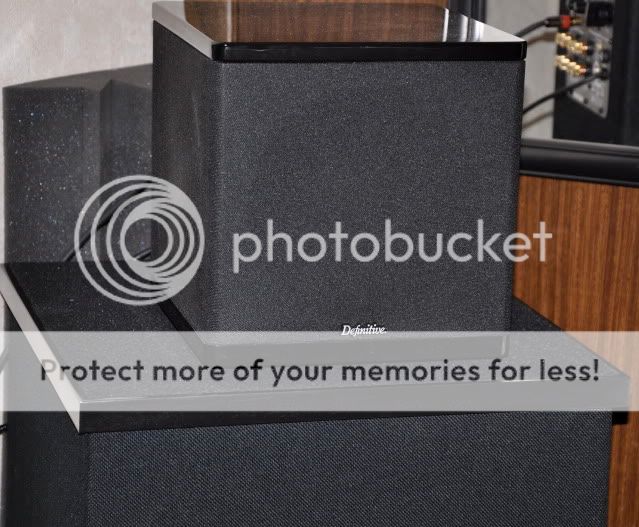

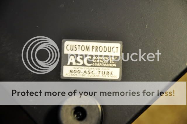

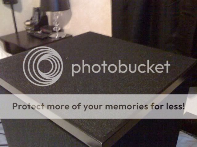

You need to perform the subwoofer crawl to find out a better position. It may also be too close to the wall. Usually, a good location for the subwoofer is in a corner, about a foot away from the walls. Since you don't have any room up front, try putting the subwoofer in the rear corner away from the walls.
I've been using a Auralex SubDude HD under my bedroom sub( Def Tech SuperCube III ) in tandem with a Auralex LENRD bass trap since late 2007. My bedroom is 11.5' x 11.5' with a 8' ceiling. The front right corner is the only spot for the sub. After finding this thread & reading up on the benefits of sub raising, I decided to give it a try. Since I have no carpentry skills, I ordered a SubTrap from ASC( from the link found in Big Daddy's thread opening post http://www.asc-home-theater.com/subtrap-flyer.pdf ). It took about 3 weeks for them to make & 1 week to arrive once shipped. It is 18" cubed, weighs 25lbs & can hold up to 250lbs. It has a very solid construction. It performs 3 functions( riser, isolator & bass trap ). By raising the sub above the level of the bed, I get better Audyssey auto calibration results. I don't have any means of measuring before/after performance, except my ears & they approve .

Congratulations. Looks beautiful and big. Don't you wish your subwoofer was that big? You would be chased out of your home by the neighbors.
