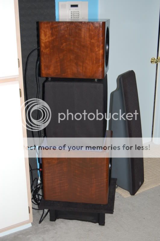

Old 10-11-2009, 12:20 AM   #835
Big Daddy Big Daddy is offline
Big Daddy's Avatar
Jan 2008
Southern California
79
122
I built a dolly/riser for my 15" DIY Dayton Titanic driver and ED-built subwoofer enclosure. You can find detailed information about the sub in Post #614 of the DIY Subwoofer/Speakers Building thread. It has a sticky in Subwoofers section.
The size of the subwoofer is 24"H x 20"W x 28"D. I decided to make the riser around 30" x 22". I purchased high quality 3/4" plywood from Home Depot and had them cut it to size. I attached the leftover wood to the bottom of the riser with wood glue and screws for additional stability. Also, It allowed me to use longer screws to attach the casters.
I attached 5" casters to the bottom of the dolly. The casters were purchased at an exceptional price of $5 each from Stanley E. Smith Company. They are the Light Medium Duty Caster Plates and have a capacity of 150 pounds each. Normally, they are over $20 each.
I covered the top with carpet. They are actually door mats with a very thin layer of rubber. I bought them for $3.50 each from Home Depot.
I also bought 1" thick foam from Wal-Mart and attach them to under the dolly/riser with 3M spray glue. I plan to cover the foam with carpet later. It is mainly for appearance.
Old 10-11-2009, 07:29 PM   #836
Nielsb90 Nielsb90 is offline
Nielsb90's Avatar
Aug 2008
Denmark
38
114
1072
I think I will make a riser for my sub! I looks fun/easy/cheap and I would love to test it! I just don't have a walmart where I can pick all that stuff up lol
I received my new sub today and its a beast! Absolutely enormous and a HUGE improvenent over my old 8" sub! I will post pics when I have completed the riser and hidden all the cables! Big Daddy you have been a big help, thanks!
Old 10-12-2009, 01:06 PM   #837
killat0n killat0n is offline
killat0n's Avatar
Mar 2008
Minneapolis, MN
72
218
The risers have had by far the biggest impact to cost ratio of anything in my HT. I actually made my first riser back in late January and from that point on I wouldn't have it any other way. I didn't even unbox my 2 new subs until I had the risers for them finished.
My first riser was pretty low to the ground. It had 3" legs and I was using some of that foam from Walmart, and right away I noticed a huge difference. So much more detail and punch, it was really like I bought a new sub. After a few months I wanted to try increasing the height and adding more/better foam. So I made new 5" legs and got a much denser foam. The effect from the riser was even more apparent now. Even more detail and punch than before and at this point there is no boomy bass what so ever. So in August I picked up another sub and decided to take it one step further by making 7 inch legs and having 6 inches of high density foam on the bottom. Once again the effect improved even more. So with all the experimenting I did I feel that the amount and the type of foam makes a huge difference along with the height of the riser. So just confirming what Big Daddy and CrazyBLUE have already stated, the higher the better and the more foam the better
I took some pics while I was making 2 more risers for my new subs.
I got everything except the foam from Home Depot.
I used a 15" x 15" x 3/4" piece of laminated counter top
7" long 2" x 2" for the legs
4 pack of rubber feet(only $1.98 for one pack of 4!)
3' x 4' Roll of carpet with rubberized bottom(this was enough for the 2 risers I made)
22" x 22" x 2" High Density Foam from Joann Fabrics(a bit pricey but it's so dense I felt it was worth the money)
I like to lay 2 extra strips down where the spikes from the subs will sit just to be 100% sure that the spikes won't eventually work their way through the carpet and touch the surface.
Legs and rubber feet attached
I used 11" x 11" x 2" pieces of foam stacked 3 high, using your basic super glue to attach them to the riser and to each other.
This is just to give you an idea of how dense this foam is. I'd almost say it's as dense as the memory foam they use in those pillows and mattresses.
All 4 identical risers in place. To finish it off, I used a long strip of the carpet to wrap all the way around the legs to hide the foam and make it look uniform.
