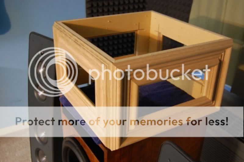

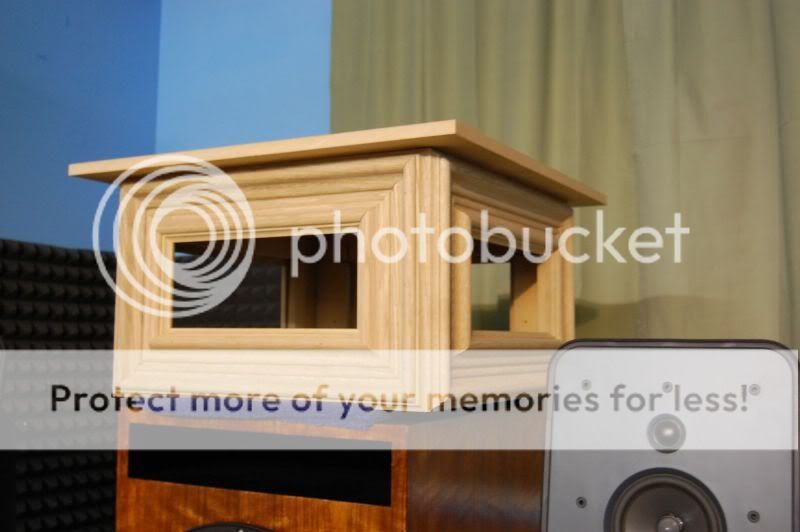

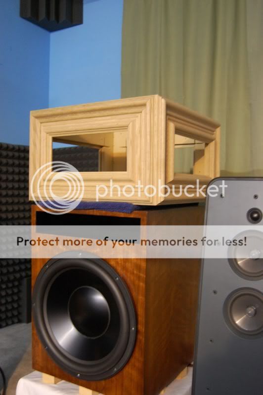

Well the hard part is over with Now the easy part will begin . This is the riser I have made for the Big Daddy/crazyBLUE Dayton 15" sub .
I think it looks Better on top Myself

545
You've taken the riser concept to a new level.
Now I'm confused. I thought it was supposed to make the subwoofer sit higher. So does this mean that a riser actually rises above the sub?
j/k Great job as always, cB! That's a pro job for sure!
Thanks lou . Just wanted to create something Unique .
Leave it to CrazyBlue to discover a new theory.
CrazyBlue,
It looks great. Are you going to put carpet on the riser?
CrazyBlue,
Nope Of course I am Carpet on top , & I might cover that with material , I will have the inside filled with foam & will have material covering the slots on all 4 sides from the inside to hide the foam . I will stain & lacquer it tomorrow Hoping the stain will be close to what is on the Mozambique , The molding on the riser is White Oak ~ Fingers Crossed ,

Nope Of course I am Carpet on top , & I might cover that with material , I will have the inside filled with foam & will have material covering the slots on all 4 sides from the inside to hide the foam . I will stain & lacquer it tomorrow Hoping the stain will be close to what is on the Mozambique, The molding on the riser is White Oak ~ Fingers Crossed.
Brent, OUTSTANDING Job on that Riser!! I can't wait to see how it looks stained, with the material over the slots & carpeted & ready to rock. Excellent (as Usual!) Craftsmanship my friend.
Happy B-Day again Aero Thank you vary much . Saturday it should be done for Testing
