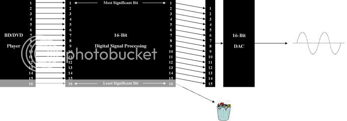

DIGITAL VOLUME ATTENUATION
Although the metadata contains different types of information, the only one that is mandatory and must be used is Dialog Normalization. It is important to remember that there are many movies that do not use DN. The dialog normalization vlaues can be between zero (no attenuation) to -31 (31 dB attenuation). The most common value for the dialog normalization is -4 dB.
The attenuation due to Dialog Normalization is performed in the digital domain before the D/A conversion. The PCM output that is outputted from the player is transcoded after the values in the metadata are applied. When DTS-HD MA and Dolby TrueHD are transcoded to PCM, all metadata (DN, etc.) is then stripped away from the encoded PCM stream. This happens because uncompressed LPCM cannot carry a secondary stream like metadata, and this is the reason why receivers do not show any DN offset.
Digital attenuation takes place by multiplying each successive word in the input data stream by a coefficient that is less than one. For example, if the incoming stream is multiplied by a coefficient of 0.5, the output will be reduced by half. This is equivalent to a volume reduction of 6 dB. In a binary system, a reduction of 6 dBs is represented as shifting the signal from the most significant bit towards the least-significant bit by one bit. This will result in a reduced resolution by one bit. This is illustrated in the following diagram:
All Diagrams are created by Big Daddy

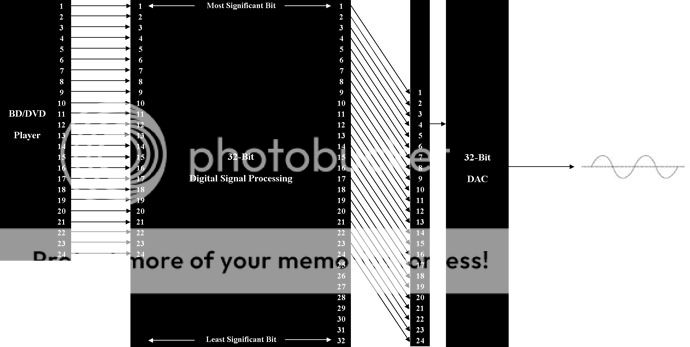

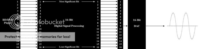

Using the same analysis, if the incoming signal is attenuated by a factor of eight, this will result in a volume reduction of 18 dB and the resolution will be lost by 3 bits.

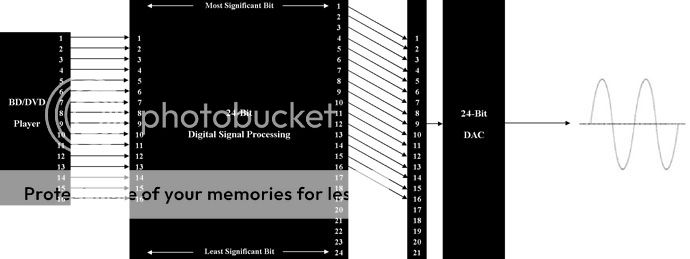

Now, let’s apply the above analysis to a practical 16 bit audio from a blu-ray movie. In practice, 24-bit or 32-bit processors and digital/analog converters are used. As a result, a 16-bit signal from a BD can be attenuated without loss of the original 16-bit information.

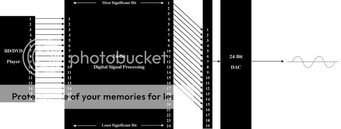

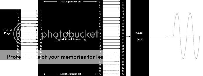

Similarly, you can find an example of 24-bit digital volume control attenuation in the following. Let’s assume a 16-bit input from a BD or DVD fed into it. The 24-bit DSP performs digital filtering and resolution enhancement, producing a 24-bit signal. The additional bits are represented by the dotted lines being fed to at the eight least-significant bits of the 24-bit DAC. Let’s assume the original 16-bit audio input is attenuated by 18 dB. This results in the loss of the three least significant bits, but the original 16-bit information from the BD/DVD is preserved.
Even if the 16-bit signal is attenuated by 30 dB, as shown below, there will be a reduction of five bits, but the original 16-bit signal is preserved intact.
The Oppo BDP-95 and BDP-105 players use 32 bit processing. The digital volume controller on these units affects only the analog signals coming out of the player. I have seen concerns expressed by quite a few people over the loss of resolution if the digital volume attenuation is used. Let me assure you that this concern is completely unwarranted. If a 24 bit signal is fed into a 32 bit processor, the digital volume controller can be attenuated up to 48 dBs (8 bits) without any loss of resolution. If the input signal is from a CD (16 bits), the volume can be attenuated up to 96 dBs (16 bits) without any loss of resolution.
Strictly speaking, digital attenuation does reduce resolution. However, analog volume controls and associated circuitry have many negative side effects such a loss of resolution caused by analog circuitry and connectors in the signal path. The degradation and noise of the analog circuitry are present under all conditions, regardless of playback volume level.
