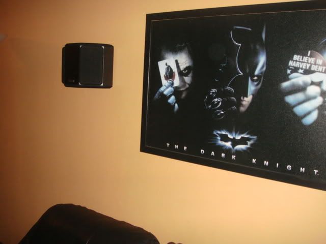

I just wanna say thanks to the OP for making this thread. I followed his advice and got the necessary tools for the in-wall wiring installation of the surround speaker cables. I was planning on hiring somebody to do this task, but am proud to say I did it myself and it turned out great. Next I shall do the wiring for my LCD in-wall. Here are some pics Before and After:

Excellent! Glad I could help. I used to be so intimidated by this kind of work, I just wanted people to know that nobody has to be afraid, its easier than it looks.
By the way, since I wrote the original post I have gone back and wired the power for the TV and the components underneath properly. No more power cords through the wall!
