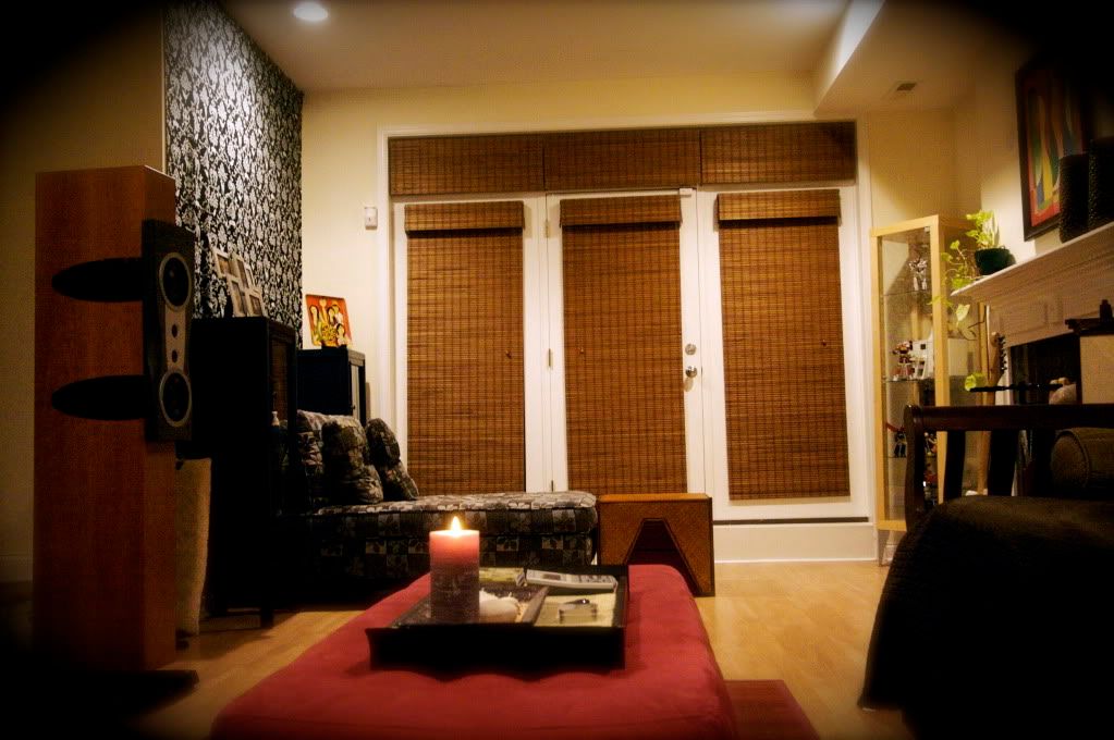

Added 2 pictures... A view of the whole basement. Anybody care to chime in on where I can purchase quality bass traps for reasonable price?

Thank you sir! BTW here are the most recent shots of the whole basement. Would anyone care to post/chime in on where to put acoustic treatments? the First picture showcases the listening are so what are your thoughts?

You'll definately want some bass traps, ideally in all four corners. Start with the front wall (i.e., the one behind L & R speakers). If you have space, a pair of the Corner Mondo Traps that I'm considering would be great for your front wall. Failing that, a pair of Mini Traps would be OK. You'd probably want something directly behind the speaker, too, although they're not dipoles so it's not so important.
The wall to your left (as seated when listening) looks angled to me, and the right wall looks relatively distant. If that is the case, side reflections probably won't be too much of a problem. But your head is very close to the rear wall, so you should really add some absorbtion there too, which should improve imaging greatly, and reduce flutter echo.
Check out the articles and videos on the Real Traps site. I learned a LOT from them!
Edit: Oh! And a bass trap for your sub from ASC would probably be a good idea at some point too.

Will definitely check realtraps out! As far as the left wall, its the drywall where the curain is hung that's diagonal. So I'll probably just start with the acoustic panels for the side and rear walls and take it from there.

First, I love the look of the room, and really like the second shot.
As to room treatment, I can't imagine treatments yielding substantial improvements in YOUR enviornment, as it seems to be pretty well furnished, with very few bare walls. The only thing I could see you doing, is maybe adding some diffusers on your ceiling.
Could you take some new photos of the front and back walls? Unless nothing has changed from the original photos.
Also, have you taken any measurements? That would be the most effective way of figuring out how your speakers and sub are interacting with your enoviornment, and take a lot of the guess work out. Not to mention, remove a lot of the "perceived" improvement.

I am just waiting on the color swatches to come so we can decide on color combos to fit the room aesthetics. The basement really needs to be repainted but that's another day . Nothing has changed as far as the rear(of daybed) wall. But that's what needs acoustic treatment the most.
Since I moved the 2 media cabinets, I have not recalibrated the sysytem. So I ran the Arcam room correction and whipped out the SPL meter the other night and was surprised to find out that there is very little reflection from the Left wall as there is only a .25db difference between the Right and left speakers.
The DDC(driver directional control) of the C2s as really minimized the floor to ceiling reflections so diffusers are next on the list. I figure get the acoustic panels firest and take it from there because as I mrntioned earlier, this room has very little issues and I don't want to deaden the acoustics.
